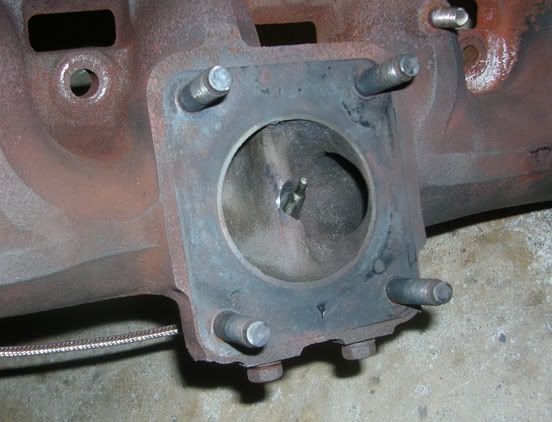

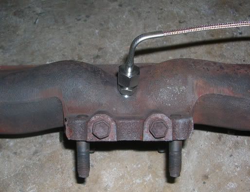

isnms
United States of America
2,145
Oklahoma
i80.photobucket.com
by jimi87-t manifold collector
http://www.supramania.com/forums/showthread.php?p=125175#post125175
edit: Some EGT info: http://www.supramania.com/forums/showthread.php?p=370984&post370984
