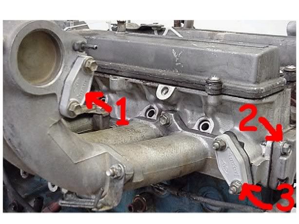

The only way to get any benefit from removing the EGR is if you remove the EGR system AND the Cooler Plate (2) behind the head and plug the exhaust port with a pipe plug. This Cooler Plate routes the exhaust from the hot side around the back of the no. 6 cylinder to the EGR system. By removing the Cooler Plate it removes this extra exhaust heat from the back side of that cylinder. By just using those block off plates (1&3) you are probably hurting that cylinder more than anything because then the exhaust gases are just trapped around the back of no. 6 without flowing. Also when you do this the second block off plate (3) is not even needed.
Hope this helps,
-Lance

the EGR cooler can be removed and replaced with a block-off plate with the engine in the car. You need a grinded down 10mm socket w/ a 1/4 din ratchet. The valve covers need to be removed and expect to have a sore back for the next week at least. Just a heads up there are 8 bolts and its not a fun task.

Think of where the EGR is run. You know that little cover on the back of the head? It routes the exhaust gas around the rear of the head. The hot exhaust gases raise the temperature of the rear of the head. If you block it off on the manifold side of the head, then it won't change the fact that the exhaust gas is run back there. However, if you block it off at the rear then you lower temps around the rear of the #6 cylinder.
Adjuster
One bolt, one plug and two taps are all you need. (And having the engine out on a stand is a good idea....) LOL
The bolt you screw into the back of the head effectively plugging up the port that leads out of the #6 exhaust runner.
The plug you screw into the hole in the upper intake plenum, plugging that port as well.
The block off plates do the same thing.
My method has the "cooler" plate removed. It's scrap alloy now.
Simply routing hot exhaust gas from the exhaust port in the head to the manifold does not increase heat in the head.
