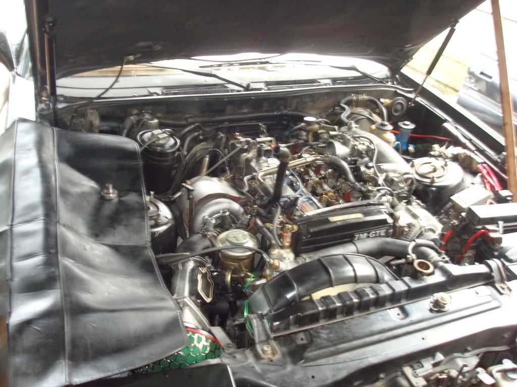

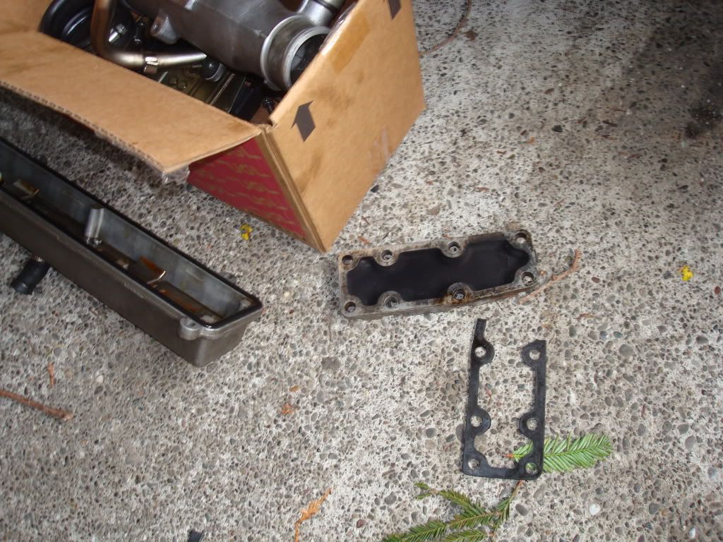

so there was a break in the storm today for a little bit and i decided i would give it a shot. it definitely wasn't fun, but wasn't as bad as i thought it would be. i ground down one of my 10mm 1/4 drive. that plus the snap in socket it made things way easier. also the intake side valve cover had to go.
here is a pic of how far i had to go. also one of the gasket (the other pieces feel under the car). in the upper right hand corner of the cooler you can see where it was leaking. the pic is sorta shitty.
