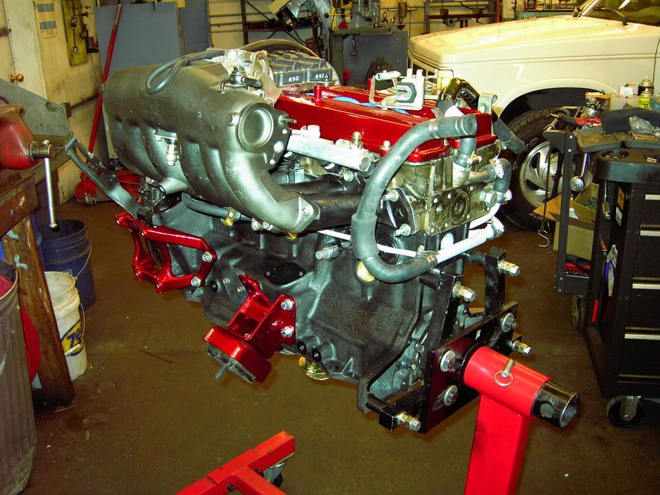

Adjuster
Parts list.
1) Large long bolt. (I just used a metric thread because I have metric taps and dies... but a SAE pip plug would work fine.)
2) Small plug.
The bolt is for the head, mine is long enough that I "ported" the end that stuck out into the #6 runner to make it smooth again. So far, no leaks whatsoever.
The plug is for the upper intake manifold. Just tap the hole, and plug it and your done.
Here is a pic of how it looks. No photos of the exhaust runner, but mine is coated as well along with the rest of the motor :) (Various thermal dispersants, barriers or powder coatings.)
