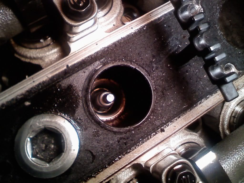

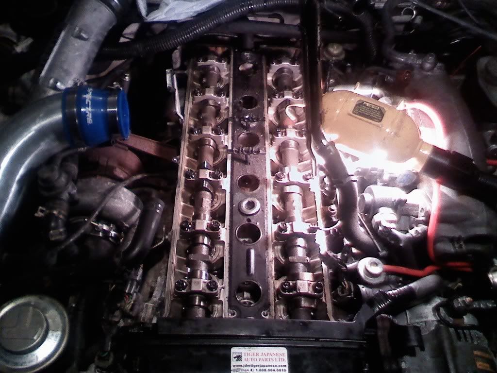

ok well when i realized i didnt change my spark plugs, i agree i'm an idiot.... i found something very interesting... the spark plug holes are filled with water and cyl 4 has a little and 5 & 6 have quite a bit of oil and water in them... so now once i take off the valley cover i will change them and let you guys know

oil ontop of the plugs is not a big deal the cover is just leaking. the water is a bit strange but could be one of the coolant hoses leaking.

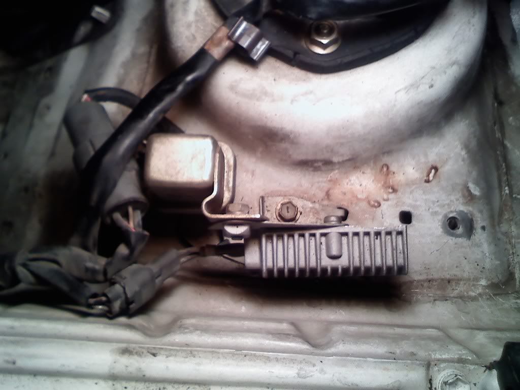

it was plugged in the whole time. was already there. here's what i did last night.. .sorry for the quality, was on my cell...
the yellow brown in there kinda looks like puss.... haha

You said it was there and plugged in the whole time, you are referring to the injector resistor pack and not the fuel pump resistor pack right? The one on the left (drivers) side shock tower / wheel well correct?

it was on the right side ) passenger side wheel well... right by the tems. I mean it cranks but doesn't seem to be getting gas... I can smell it sometimes but figured i should change the spark plugs ( bought this as a jdm import) and found the water and oil. will get new seals, just need it to run a couple weeks then am gonna do a mhg arp studs and valve cleaning.

No, that is the is the fuel pump resistor that is on the passanger side, not the injector resister pack....
The injector resistor pack is mounted in the same spot but on the drivers side....

That is the fuel pump resistor pack, not the injector resistor pack. The injector resistor pack is in the same spot just on the other side..... Refer to the link that dumbo posted in post #9 of this thread IIRC..... Look scrolll all the way to the right (i.e, looking at the drivers side of the car in the photo and you'll see a box that looks similar to the one in the picture that you posted but again, its on the drivers side. I'll have a 4 wire plug.....

You should have a 4 wire plug that comes out with the igniter plugs from the enging harness along with the engine to chassis plug over there right behind the battery and fuse box. I'll bet that that 4 wire plug is not plugged into anything and it should be plugged into the injector resistor pack...
