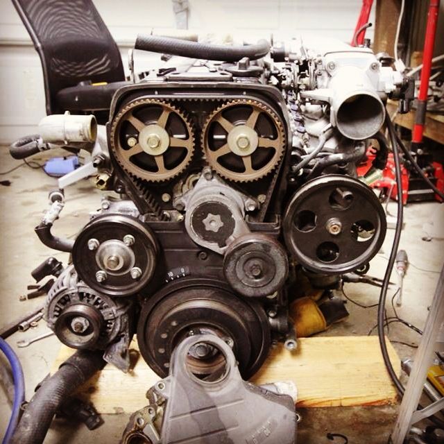

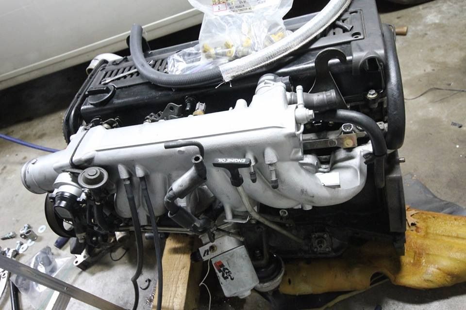

Well after all the money I'll end up spending going 2jz 4l80. I picked up a 1jz, and going back to r154 once I sell all the 2jz stuff

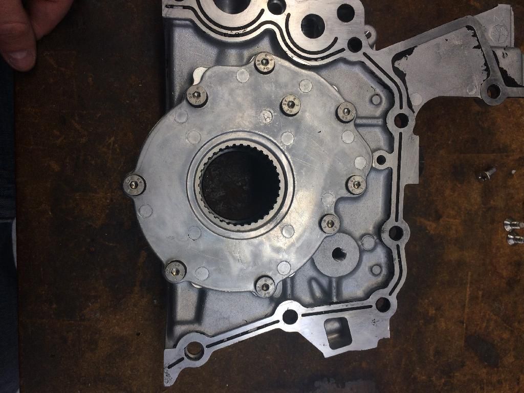

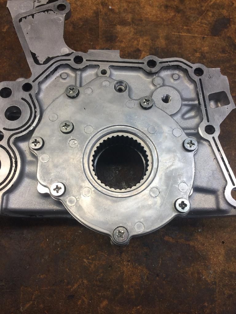

19cturbo;1981526 said:
any clue why the pump failed? just curious here... and whats modified on the 2j pump?
Well the back bolts on the oil pump came undone. Probably from previously owner never locktiting them.
I put new hardware on my modified 2jz pump and locktited the hardware in there.
Old hardware
New
