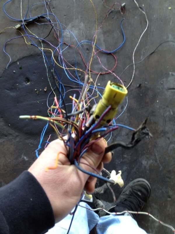

Got some work done. Thanks personally to Steven Reedholm(stevenr816) and Dahn Automotive.

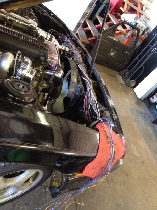

Relocating junction box:

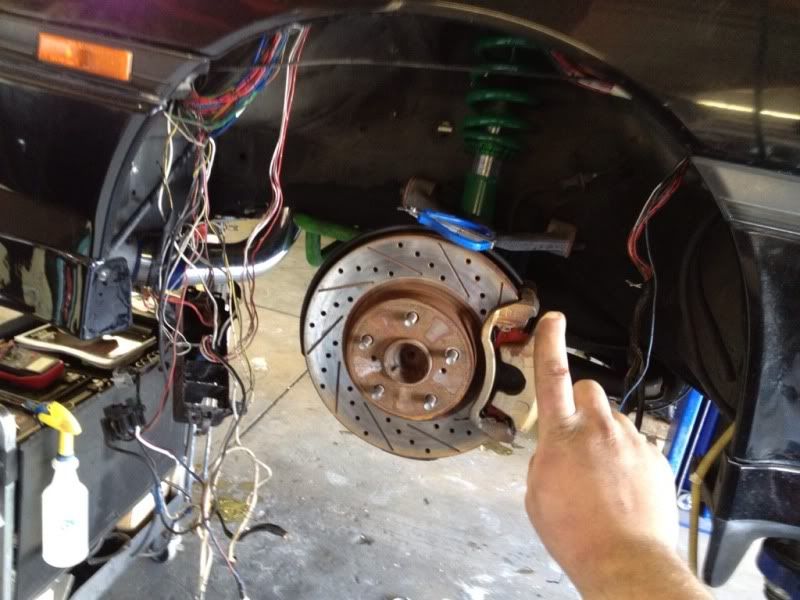

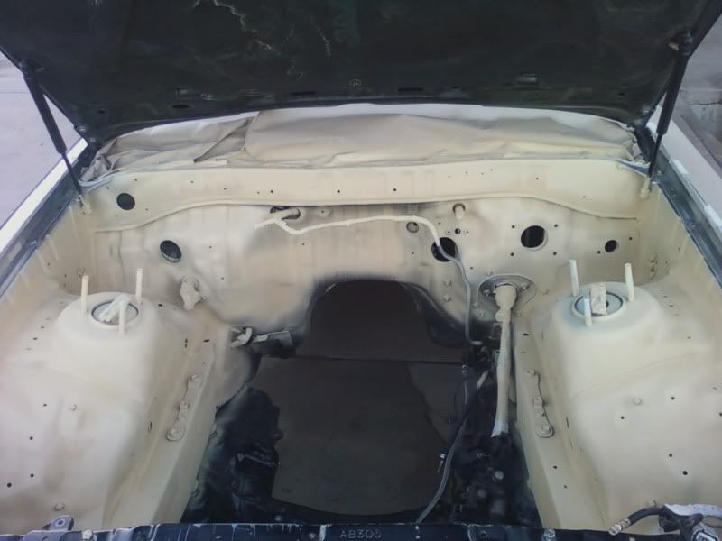

The hole near the throttle cable*; is that the hole you used to run the engine harness for the wire tuck?
xzeror
Oct 18, 2009
1,356
Miramar, FL
thats what i meant to say >_<, Thanks! Did u have to pull out the dash to pull it through, or can it be done with the dash on?
Albert
May 13, 2009
1,710
Tempe, AZ
I took off my gauge cluster, ran the harness through the hole, up into the back of the cluster, over to junction box.
No extending needed. Then put my cluster back on.
