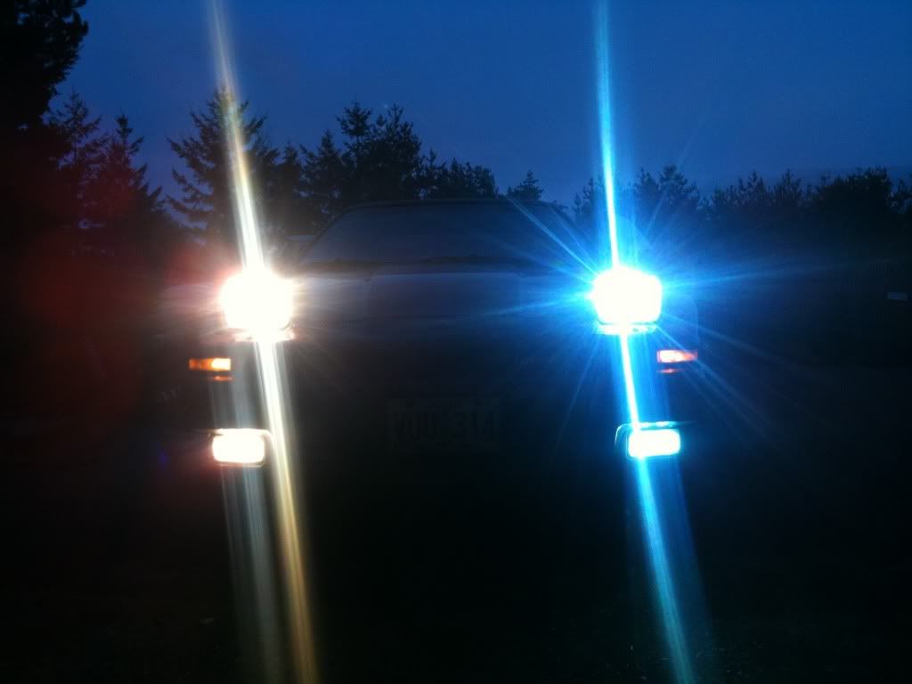

What to do is make sure you buy the HID's from an american buyer!
I did this and it works really well! I bought some Ebay H4 "projector" headlights. buy a good HID kit not from ebay. I also did my fog lights in HID's with the same color. to be honnest all you need to do is aim your headlights down a little and it doesnt cause the super bad glare that you have seen on other cars. I have driven past my supra with these and it is no worse than driving past a Mercedes with HID's. ID say go for it!
These look lots more blue in the picture than they really are. they are 10,000K
left is just your typical halogen lights and the right are the HID's

Um, no :3d_frown:
Unless the cutoof looks even close to this http://www.theretrofitsource.com/images/products/hid-projectors/TL Projector Output ZKW-Rl.jpg (which I know it doesn't), you're the reason states are passing laws trying to ban HID's. Also, it doesn't matter where you buy the HID kit, they're garbage if they're rebased bulbs (i.e. if they fit in an H4 socket, they're rebased).
You might like how that looks, but people in the know see it as rice.

^and 10k.
10k is way to bright. Its the worse thing ever. Honestly id rather have a drunk driver coming at me with proper headlights than someone coming at me with 10k. It way to bright to the point where i cant see the road the lines or even the car with 10k lights.
Your lights are way too bright. get max 5k and be done with it. The higher k does not mean you have better light. And blue doesn't do shit but make your usable light even worse.
Edit you cant even see your projector if you even have them. Proper hids you can see the projector when the lights are on as long as your not looking at the cutoff or below. Your lights are scattered as hell.

no the ones blinding you are just misaimed and/or using HID in fluted glass housings meant for halogen bulbs.
this is why i'm just going to buy some cheap clear glass housings and retro in some FX-Replica or morimoto mini projectors in there.

They were in a benz or bmw tho. There are some that i see that are just plain way to bright and there are the ones that are just scattered. Maybe it was just bright and aimed wrong but still im thinking of some lights that shouldnt be sold.

what I was trying to get at is that if you aim them right you can still see and not blind others with the kit he was looking at getting. at least mine arnt that bad with what i have done with them. I have seen hondas have much more glare.
My plans later in life when i am done with college and have money to waist on the car is to get some projectors because i am aware that they are far superior, but for now this setup works and I can see far better at night.

No. If you aim them down that low you're getting worse lighting than stock.
