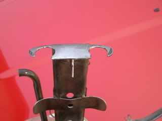

ok... Can I get to at least 600hp to the wheel with the dual walbro hanger and 255lph walbro on it...
what size of fuel lines will I need to feed from the fuel pump to the engine? -8 or -6
what size of fuel line in return from the engine to the fuel tank? -8 or -6

i have a dual hanger with walbros. 2nd pump comes on via aem at 5 psi. i have run over 550 rwhp on them. i ran -8 to stock fuel rail and -6 to afpr and to tank. i have the arizona dual hanger. ( i think thats right.) i think i can get more hp out of them.
hal
