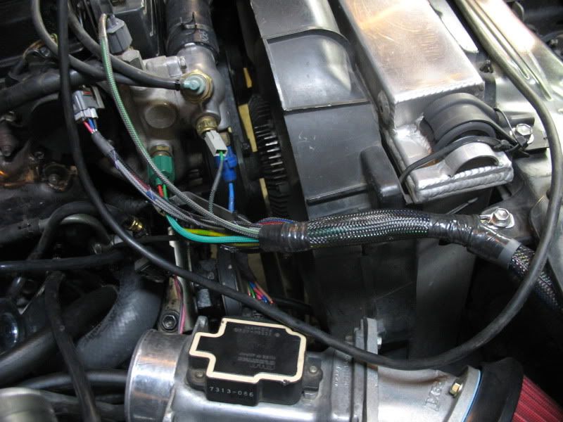

Mishimoto is rounded. THe closest thing to making it not a drop in was that the hose inlet/outlets were a tiny, tiny bit smaller. Normal hoses work just fine, but you may need to use a new clamp (you should anyways).
See below:
