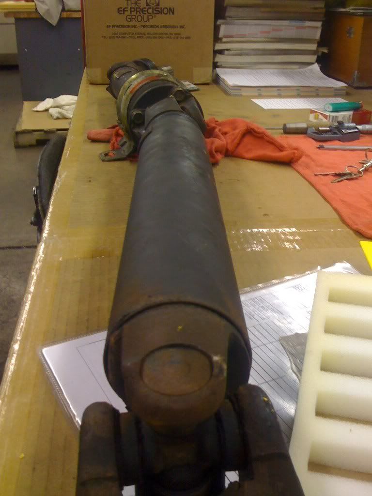

gaboonviper85
Jan 13, 2008
3,236
Northeast Philly
Seems my pic doesn't work so I'll post it here again..
