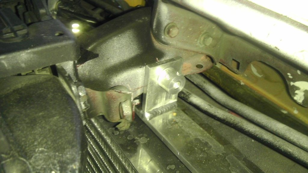

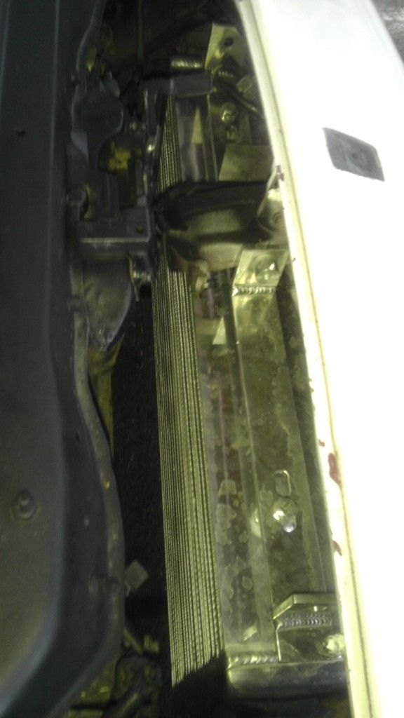

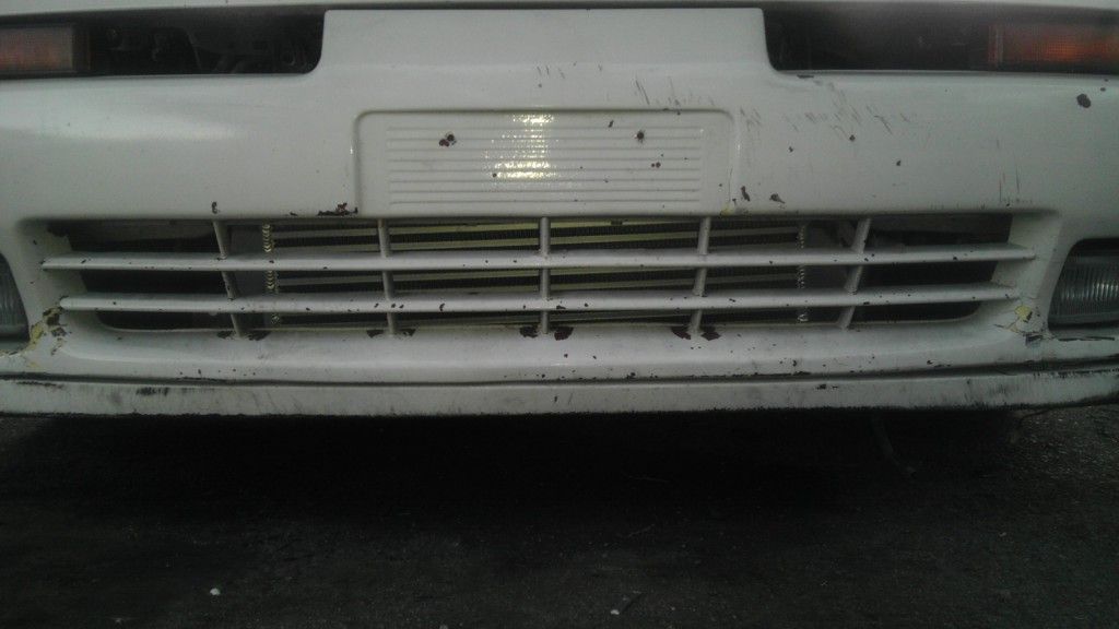

I took some pictures by request of how i mounted my intercooler.
Remember i do not have a 7M intercooler kit from DM anymore this is the 1JZ intercooler but mounts up basically the same
I hope these photo's help

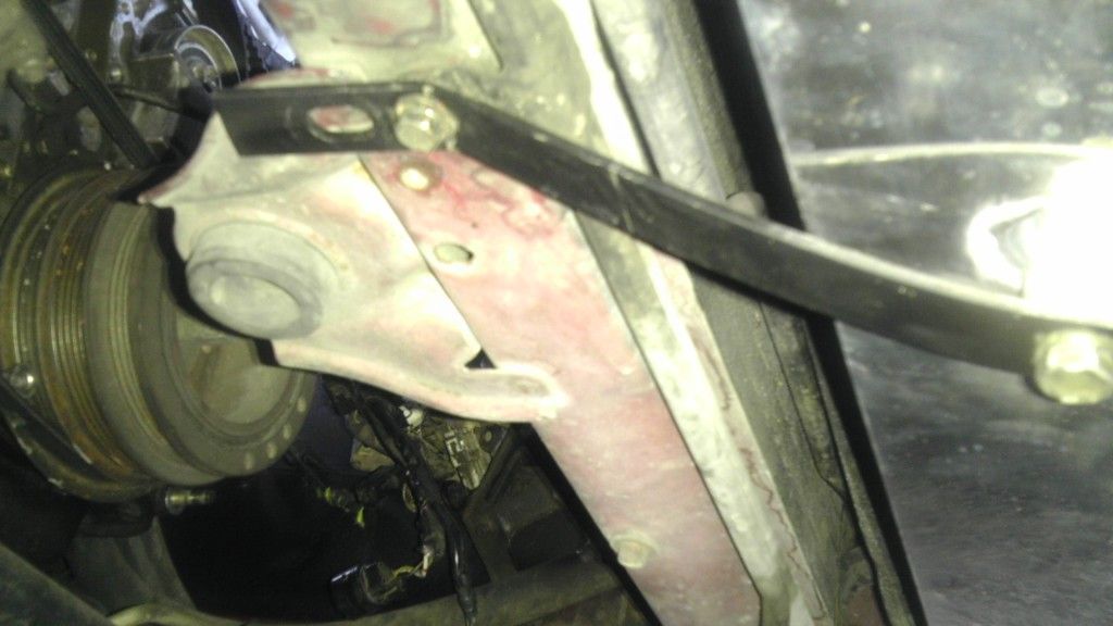

Top of Intercooler Mounted to Hood latch/horn bracket Mine has been cut and modified to fit big intercooler

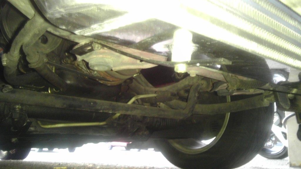

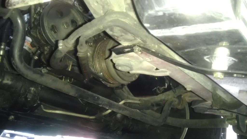

Bottom of the intercooler i simply used to bolts that where already in place under the car worked really well and my intercooler has zero movement

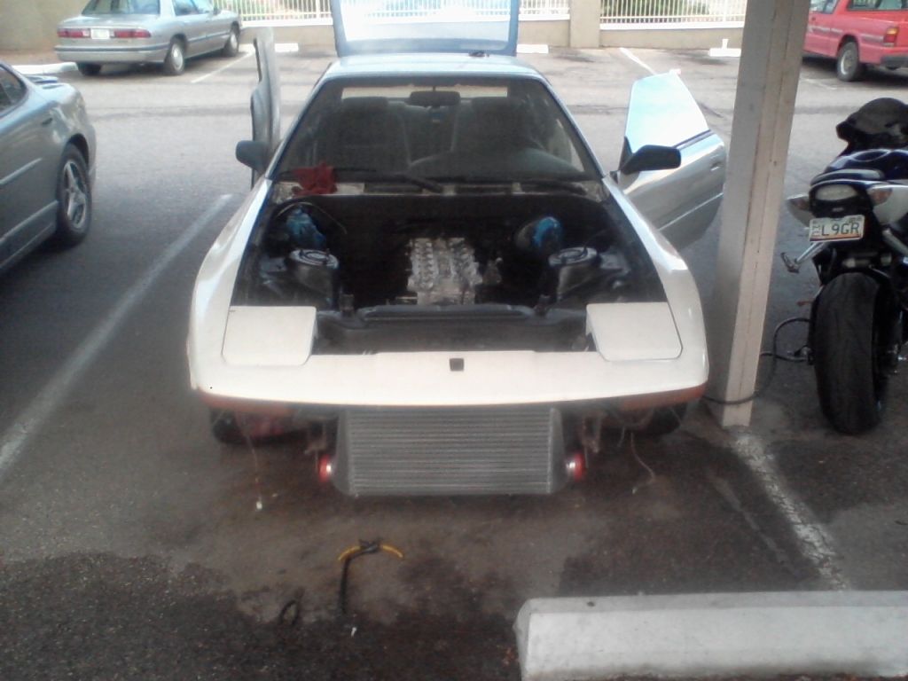

And whala it's mounted to me about 15min to do

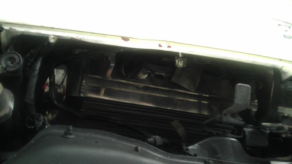

Looks alittle cooked in this photo because this was before i mounted the bottom.
