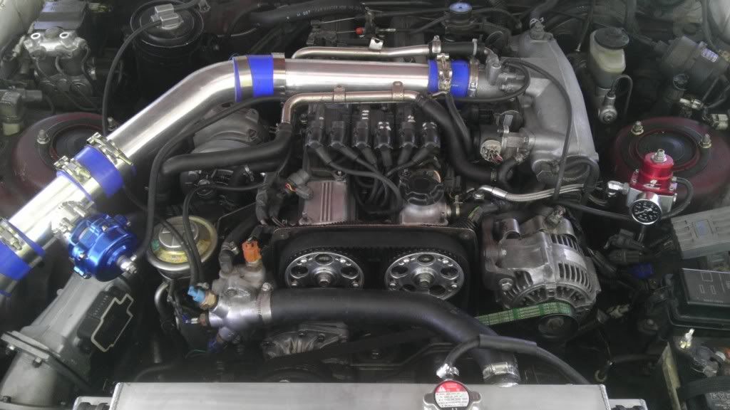

Oh i thought you were talking abouiut the 3 holes in the accordian sorry.
the one that goes to the 3000pipe will eliminated because you will no longer have a 3000 pipe the little hose will still be used as a vacuum source for the SSQV BOV

Mine was a little modified from the original kit but you get the point

No not really. Might be easier if you jack up the car to get under it.
But only thing to watch for on the front of the outlet on the turbo is a little lip if you slide the coupler to far up and over this lip you will have a big boost leak
