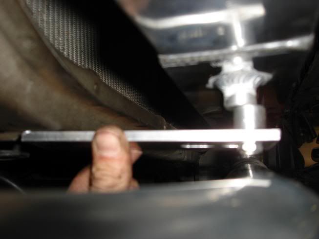

then i made little metal mounts to hang the intercooler these are only 1/16 inch steel and worked well so here is some pics to copy them if you want
