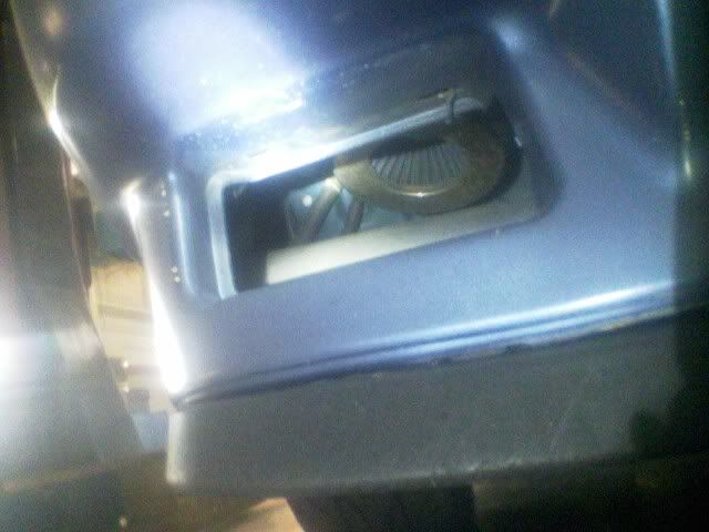

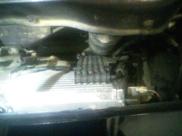

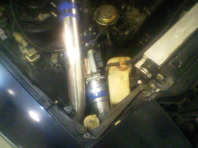

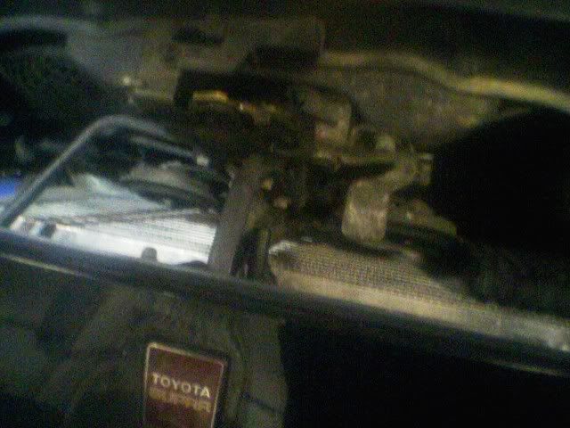

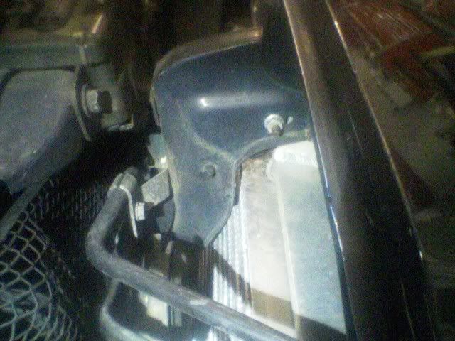

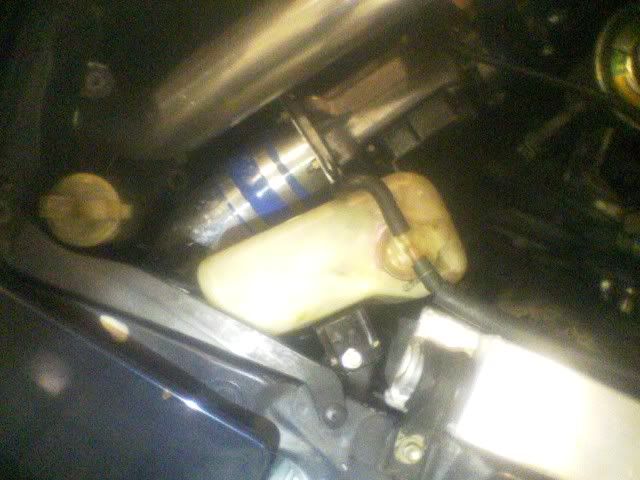

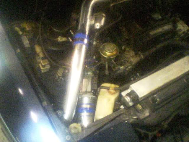

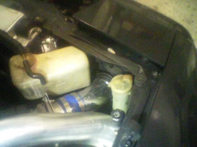

For anybody that may be interested or still lookng for a visual example of how this kit fits, I have pics. I did not get good pic of the upper 3000 pipe, but if you've seen one version or another you pretty much get the idea. This is the example I described in an earlier post:
The relocation of the coolant overflow to the stock air box location (approx.) and the cold/ram air mod. The Accordian Pipe has been replaced with a cooleze intake pipe and the other pipe on the front side of the AFM came from Pepboys, LOL!
The relocated filter from the bottom
The latch bracket, uncut, not shaved
Horns
Oil cooler relocation, behind intercooler
Sorry for the poor pic quality. As you can see, though, the fit IS tight and this took a few hours of fiddling with to get it fit this good. All piping is 2.5" and this car has a 3" exhaust as it's only other real "power" mod, and it pulls hard for just those two mods.
