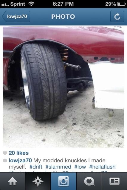

I have been messing with and drifting my mk3 supra for a while now. I have a build thread on supraforums.com. My name is still planemos on there. I took some good pics of how I modified my steering knuckles for more angle.
So you got rid of that other mk3 shell? I hope you don't need more parts later on.
I've seen a few guys mention that you should rebuild the 7M. DO IT. I didn't and now I am 2JZ swapped because the 7M didn't hold up very long for drifting. Rebuild it or start saving now for a new engine/swap. And getting some new suspension bushings is a good first mod to do I would say. Also replace the spherical bushings in the rear knuckles. That all helps to tighten up the feel of the suspension. You don't have to buy coilovers at first but you will want them. I did my first drift event on cut springs. It was the worst but at least I was out there on the track learning about car control.
