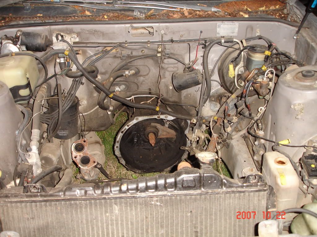

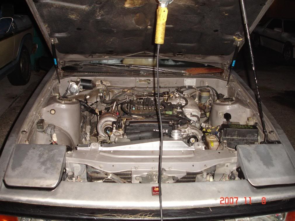

and just for shit's and giggles here's what my mkii looked like when it was given to me.
idk why but i put a 7mge cover on the turbo motor i droped into her lol

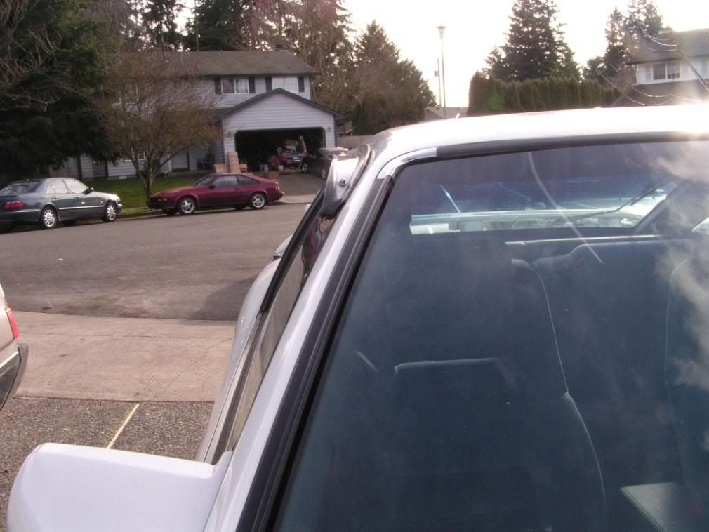

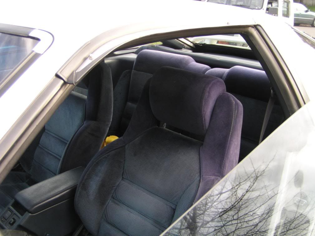

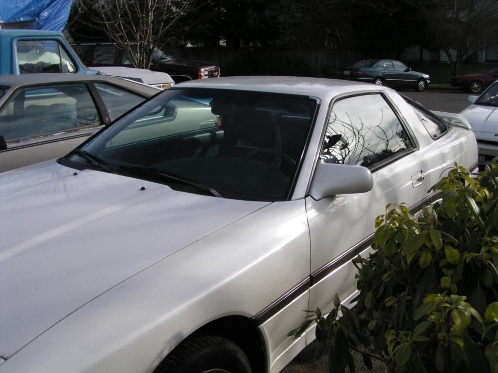

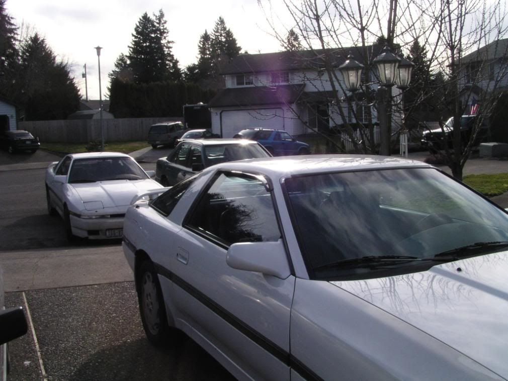

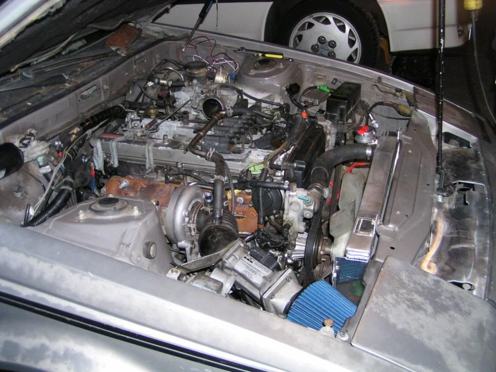

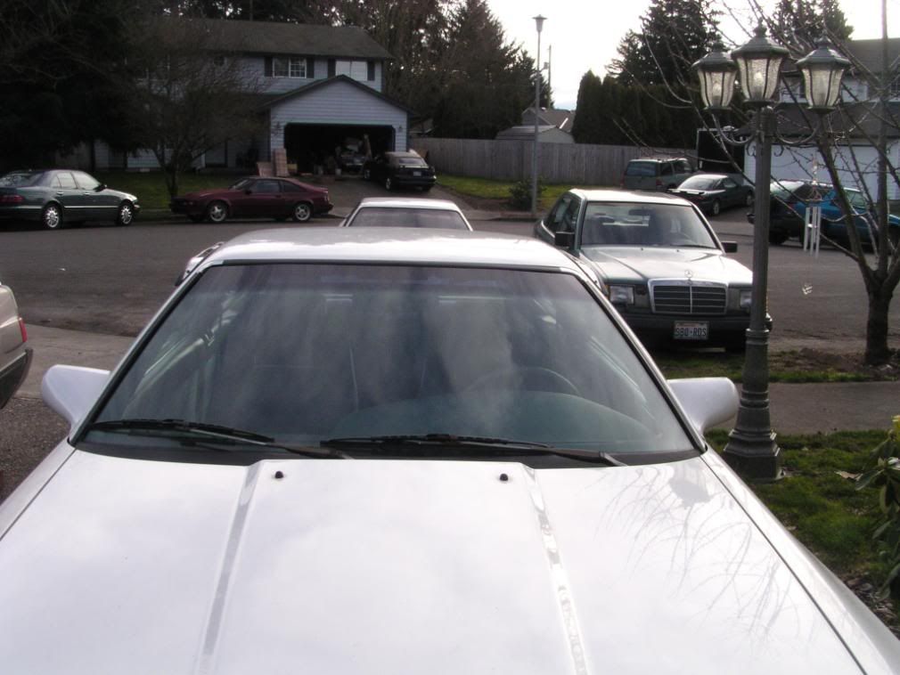

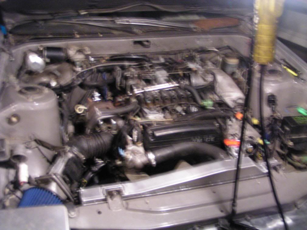

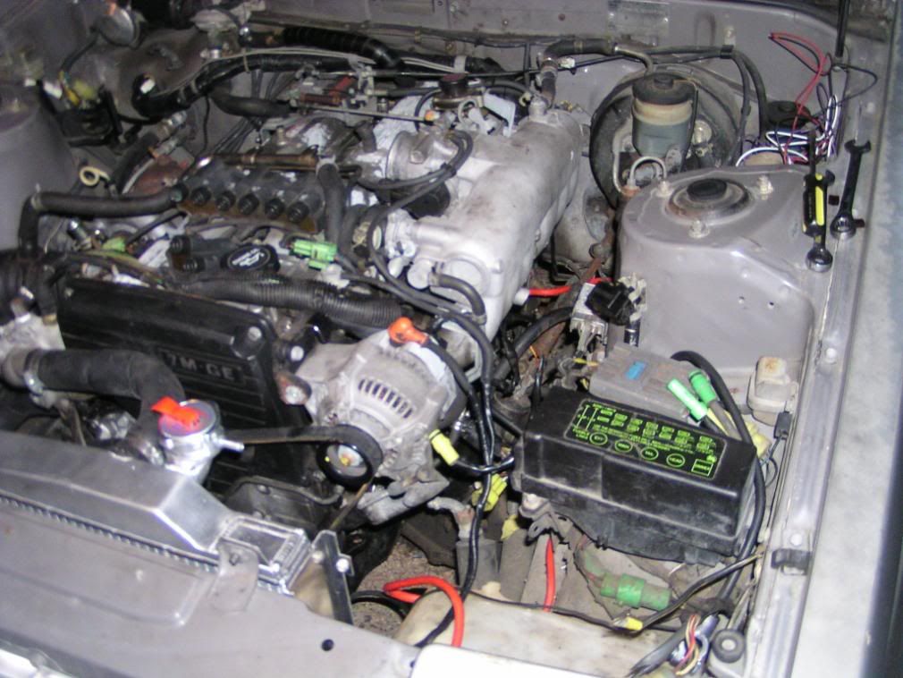

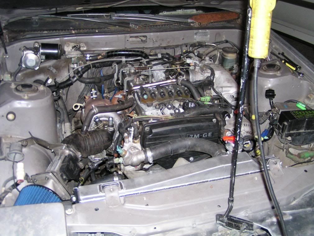

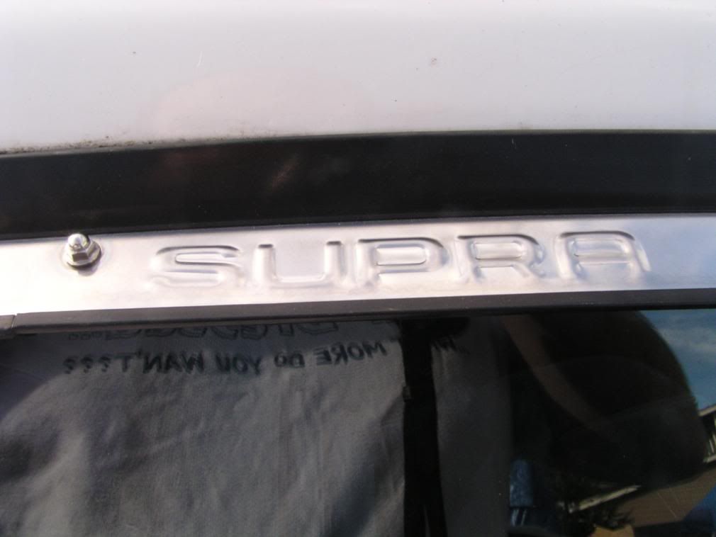

well since i had mentioned my new supra that all my parts swaped over on, i decided it's about time i post some pictures.
thanks! JustinGotA1j ,
for some reason i couldn't get hte color to come out right...
and a couple new one's of the mkii i've been building.
ewww fuzy...
and new battery cables :p
thanks for checking it out~!:aigo:
