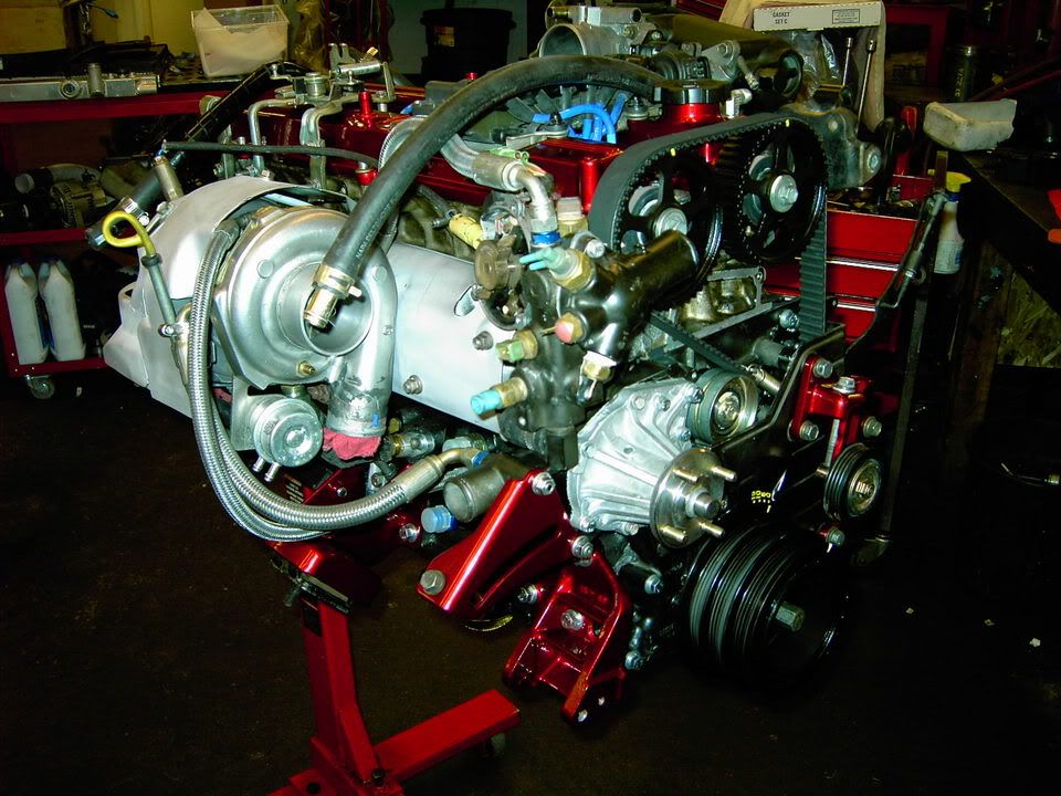

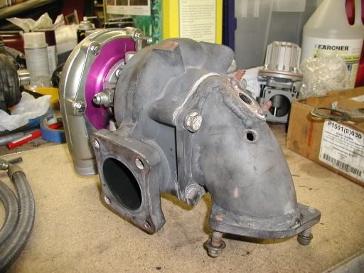

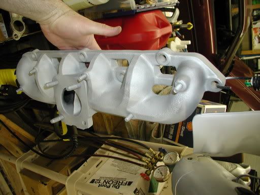

Here's what it looks like when done. (The red is candyapple powdercoat, black parts are TLTD, silver is ceramichrome that is not polished and black hot parts are "turbo X" a 2000f ceramic coating that has been very effective at lowering underhood temps.)
This bolt on T4 hot side and elbow were coated with turbo x, and it changed the engine bay from a blast furnace to actually pretty cool. I never did, but you got the impression you could touch the housings even after a running the motor hard.
I also coated the manifold and heat shields to keep as much in there as possible. It makes a big difference in my opinion.
