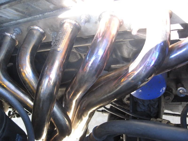

Personally, I would make a header like this:
A few people have been able to get 200rwhp on IS300 with this design, so I think it is good enough for us. I can get one of these, take it apart, and re-weld it to a 7mge fitment. This way there isn't that much cost into it.
This seems like a good plan.
