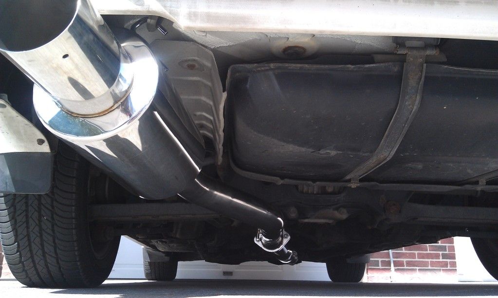

This was the first mod I did to my car. Full 3", downpipe and "cat-back."
Bolted right up, included gaskets, hangers line up. I think you may need a 3" exhaust hanger for where the second cat used to be, I know I did. You may not.
Overall, easy to change out, maybe 20 minutes on a lift, and sounds amazing.

Sounds great, fitment is okay (hits the rear subframe, but idk of a 3 inch exhaust that wouldn't) and sounds amazing.

That's honestly the problem with my dm exhaust. The flanges are likely warped slightly so it barely touches the subframe

Thinking about getting this exhaust as well, sounds like the only issue it it may hit the rear sub frame and some flanges may be warped?
IndigoMKII
May 9, 2011
2,181
Madison, Virginia
The flanges being warped are because they're not supported during welding and the gasket is normally thick enough to seal.
It does rub against the subframe.
