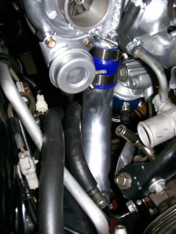

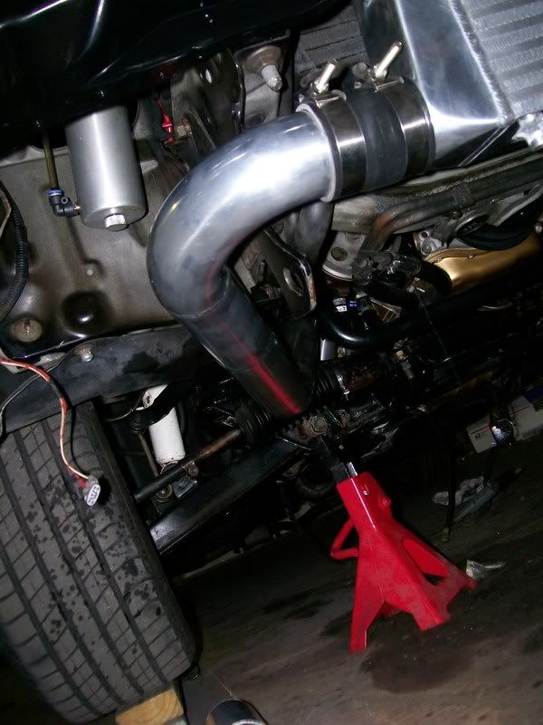

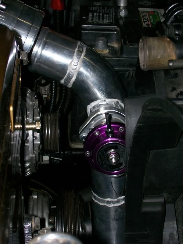

CX racing on Ebay sellers the best material in the generic DIY piping. Thicker then most. The couplers are not the best but I run 18psi no problem on my 92' but I run buldge couplers from www.Hightempsilicone.com on my 87'. They sell extremely good couplers. But overall the kits from CX are very weld-able and extremely nice clean bends. My last kit was (2) Straights, (2) 90's, (2) 180's, (2) 45's and cost me $125 shipped in 2.5" with couplers and T-bolt clamps! Can't beat that even if you have to replace the couplers!
HTH,
Seth
Pic of routing w/ FFIM:
