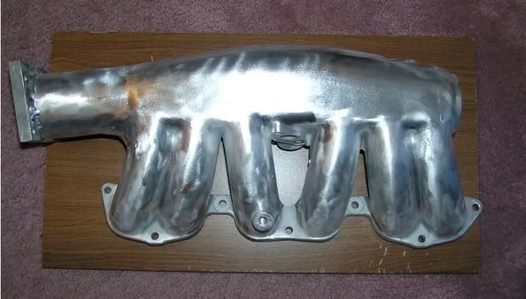

Thank you to whom ever posted mine information, stock modified to front facing is relatively cheap and effective, flowed roughly 5% better and more even across the board, I had a post on SF and it was done on a super flow flow bench. Here are a few others:
And this one is my first modified stock one:
Made 440rwhp with it and was only limited by electronics at 18PSI!!!
Thanks and HTH,
Seth

Wow sethron71, that oem to ffim looks pretty good. How did you weld the aluminum without warping it?
Also, you wouldn't happen to have any unneeded long runner ffim's your willing to sell, do you?

i made modded stock one i made it befor sethron71 and i did alot of work to it as well removed the egr aka grden ti all off removed and filled the stop opeing and did some port work as well i sold it here on supra maina so other dude in cicago has it now
i say to any one that si one fo the best thign you cna do whiel still keeping it simple

Nashman looks good, never saw that one before I made my first stock converted one but I like yours!
Ha Ha, Yea I actually have a fully polished long runner custom with a polished 3"TB and Alternator Drop Down Bracket. Hit me up if you are interested.
