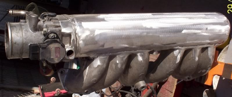

A nephew of mine works at a metal fabrication shop that builds custom parts for customers like aap, balanced performance, etc....
I just cut up thick paper into the shapes that I need. He takes them and cuts them on aluminum, ss, or whatever I need it in . Does all the welding and fabrication for me.
It is tig welded. I haven't tested it and will have it installed when it is warm again. I have a Q45 throttle on it now. The stock one was used just for mocking up.
I do have a few parts in the works. WIll be ready for sale sometimes next year. Intercooler block off plates, nightpager brake adapters (might have MK4 ones too), 3 inch throttle body in the stock location, and a few others...
