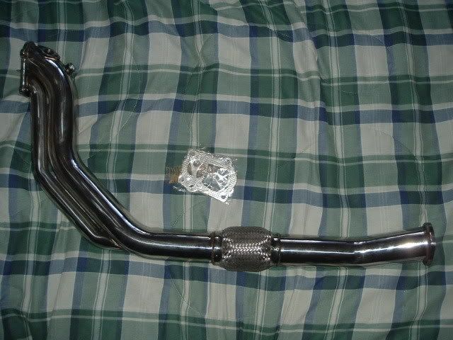

I've heard and read it's better to get the flex section because there is less stress on the turbo when things expand and contact from heating and cooling. The kind of sound I want is the turbo spool and it seems that if I go with the vented DDP the turbo spool sound would be overwhelmed by the wastegate at WOT but if it's not that bad then I'll go with a vented DDP and save the extra money.

ive been running an ebay style ddp for about 5 years now that already had the divider tab, flex section and recirculated (i like the area it recirculated back compared to the bic dp but don't know if it really affected anything)
if i was to get another ddp i would go with bic or raptor racing
i also had another bung welded in for my wideband in the area right before the flex section and kept the other one capped

Y'know those rubber motor mounts? They let the engine move about a bit. More so than the rubber hangers for the exhaust do anyway. Also, if your exhaust hits a speedbump, I'd rather that the flex section of the downpipe take the hit than have the turbo take it on the chin (And pass that on to the exhaust manifold/head.)
