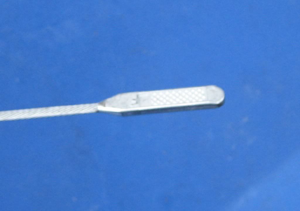

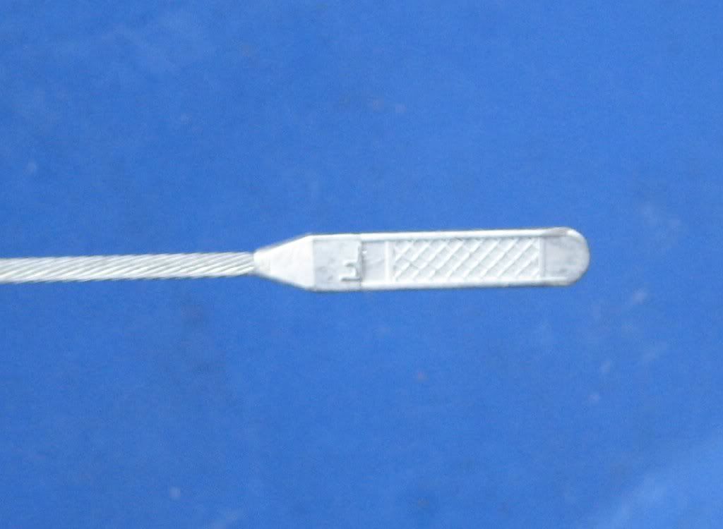

3p141592654 said:
This is the new dipstick. Much easier to read than the earlier ones.
15301-42012 $10.22 dipstick

^^Thats the one, works great, I have no problems reading the level on the new one. I think I payed around $12-$15 for mine, it's well worth it. (as others already stated ;) )
