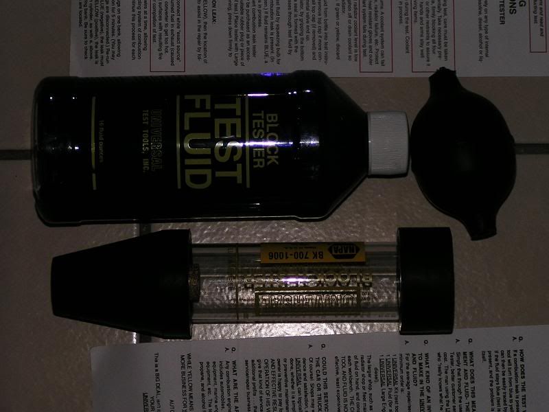

One way to see if you this leak is to have a BLOCK TEST performed (see pics 1&2). The way this test checks for a leak is by “sniffing” hydro carbons in the coolant from the radiator neck. If the color of the liquid in the tester changes, it means that exhaust gases from a cylinder/s are entering into the coolant passages.

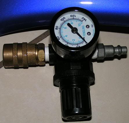

A leak down tester (see pic 3) can also be utilized but has some of the same disadvantages as a compression tester (does not diagnose intermittent leaks or leaks that only occur during high cylinder pressure). If you perform a leak down test & see coolant flowing into the reservoir, or coolant coming out of the radiator if the cap is off, you know you have a leak.
Info on how to do a leak down test can be obtained by the following thread by me
http://supramania.com/forums/showthread.php?t=2229

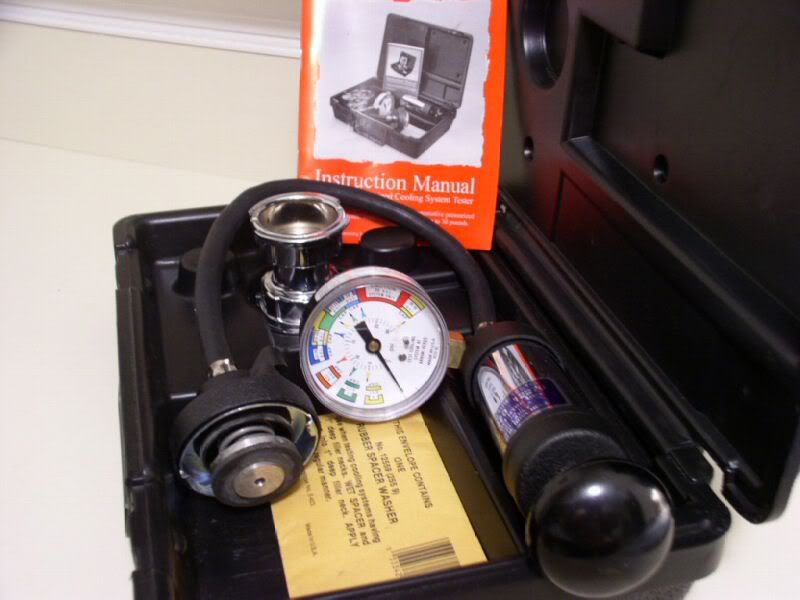

One other way to check this is to use a Coolant System Pressure Tester (see pic 4). Again, the pressure involved with this tester (low double digits) may not be enough to show up anything unless the gasket is really bad.

Block Tester
Leak Down Tester - how to make it & use it here--> http://supramania.com/forums/showthread.php?t=2229

Block Tester
