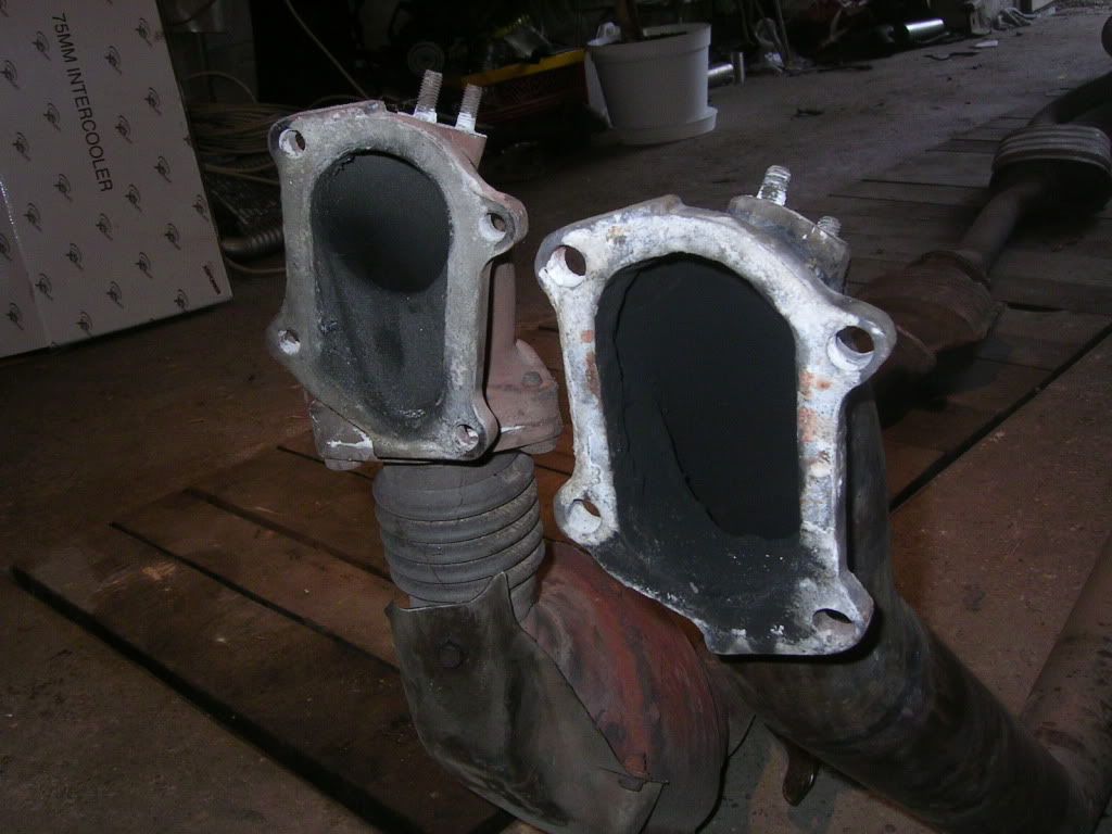

Another comparison. I dont know who thought this was a good idea...

Back to the topic though, I am a fan of DDP vs Elbow + DP. If your "building your own", the elbow + DP gives you a lot more flexibility and may actually be cheaper, but having gone down this path already.. I am happy with my DDP. (no constructive comment about performance to toss in... I think the difference between the two is minimal, but not sure)

LOL, you guys talk a lot. Sorry for waking up a dead thread but we were able to get an elbow, but it was cracked and all that so we'll have to get a refund. A guy is coming sometime soon to buy a lot of parts off my parts car so I'll have a little bit of money hopefully.
Just looking at bic 3" DP vs Bic 3" DDP. As it sits the only mods it will have is exhaust, and 57 trim rebuild in the future. Is there a big of a difference getting that DDP or should I save myself 100$+ and just get the standard one? What is the power difference? From what I'm reading a screamer pipe will get super annoying after a month or so.

Seriously don't think there's much of a difference at all. The only difference would be in flow. There is turbulence built up if the waste gate dumps into a "wall" like it does on the stock set up, but its nothing to be overly concerned with in my opinion.
I am just removing my raptor racing DDP and loved it. Wasn't overly loud, had the elbow integrated with a divider to prevent turbulence and was just a quality build overall.
I would be more concerned with properly porting a head before I got hung up too much on the elbow.

DDP should really only change the sound when you're at the boost pressure that your wastegate is open. At that point, it's definitely going to get louder (Unless your DDP is recirculated, in which case... Probably zero difference.)
A larger DP than stock will help with flow through the turbo, which means faster spooling. That may change some of the intake sound, but there are other things that will affect it more.
Most of the sound from your exhaust really is determined by the catback. In that case, it can be reasonably quiet (I really like my Tanabe Hyper Medallion for that) to obnoxiously loud (3" straight pipes anyone?) but with a turbocharger, even straight pipes aren't going to be as loud as my old V8 was.

The difference is very noticeable. IIRC BIC did a back to back dyno run with them and gained quite a lot of power with the DDP.

Also performance difference versus the DPP versus standard Bic DP. Is it worth the extra 150$? I'd have to get it recirculated.
