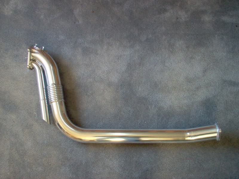

Emeraldage;1904092 said:
Just replacing the stock elbow a big difference? Because I mean stock exhaust is rather big tubing for how little power it had haha. Hopefully with exhaust, fuel pump and intake I'll get close to 300ftlbs torque.
This is somebody else's picture, but you get the idea.
