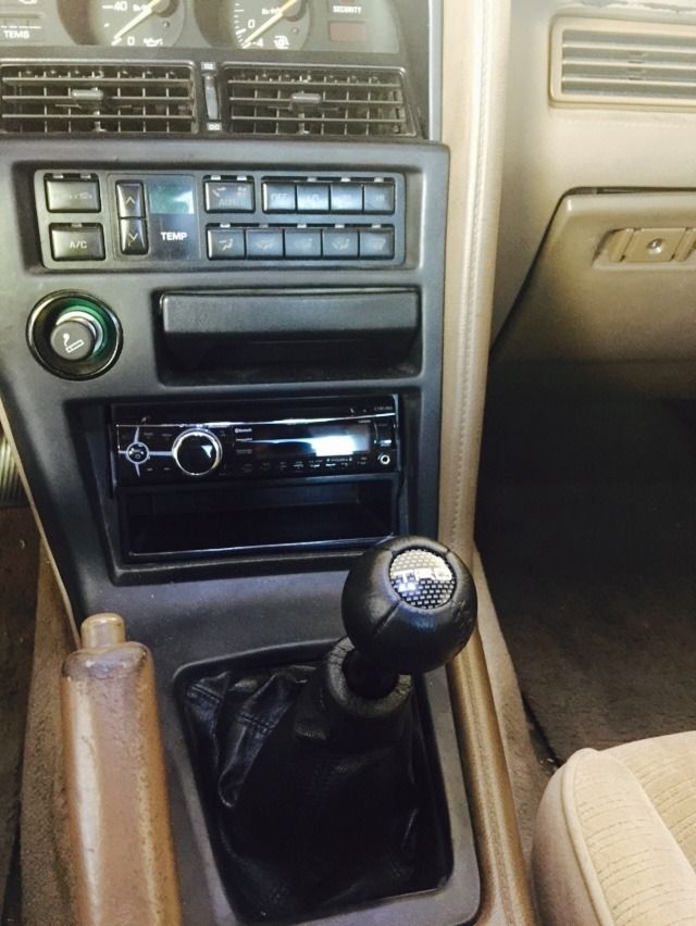

Last week I purchased a Very complete 1987 supra turbo 5 speed targa. This car fit everything I was looking for minus the JZ swap but after driving the car the 7m felt very good and sounded amazing because of the Turbo back HKS exhaust. There are a few things I want to do to the car that include replaceing all the weather strips on the targa and doors and rear hatch. Also adding a Wide band and have a tune done by UMS since it has 550 injectors and lafm.
First day picking it up
First fill up
After a 1 hour drive home

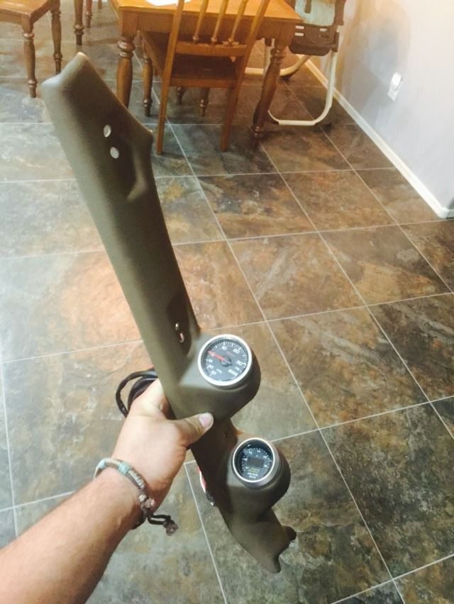

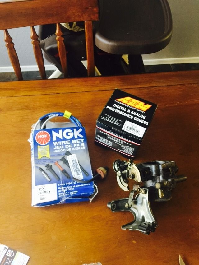

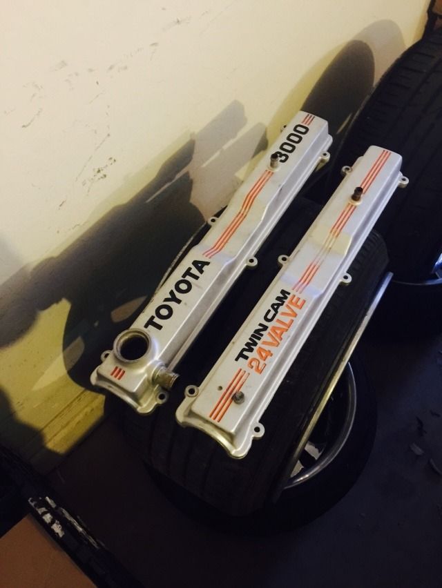

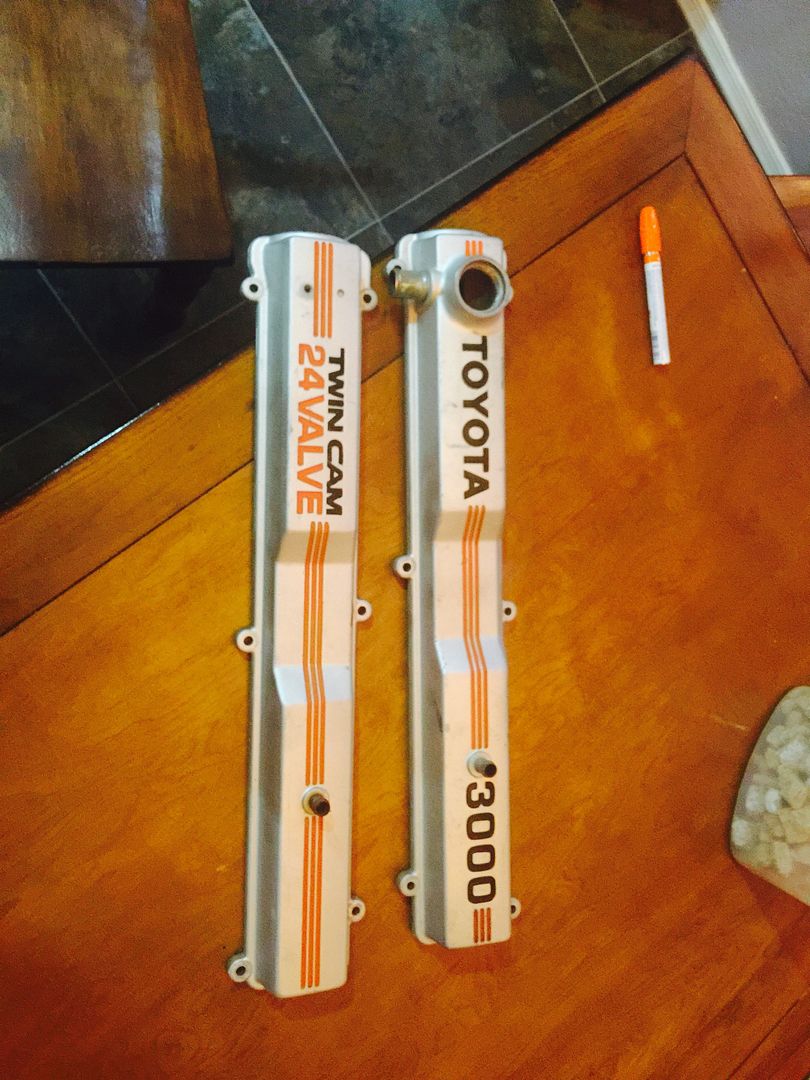

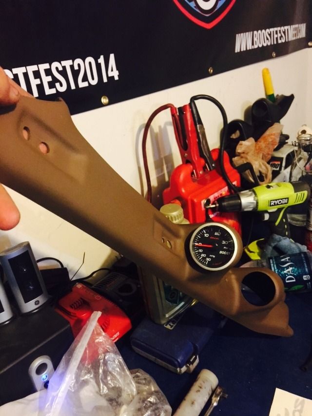

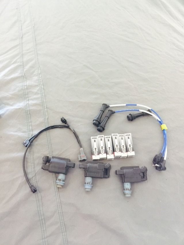

Lastnight I spent sometime detailing my NA valve covers and started wiring my gauges defi boost and AEM wideband so I can take it and get tuned. I also got some goods in the mail so I can put the new valve covers on I got new NGK 2jz vvti wires and a JDM throttle body last piece I need is a throttle cable.

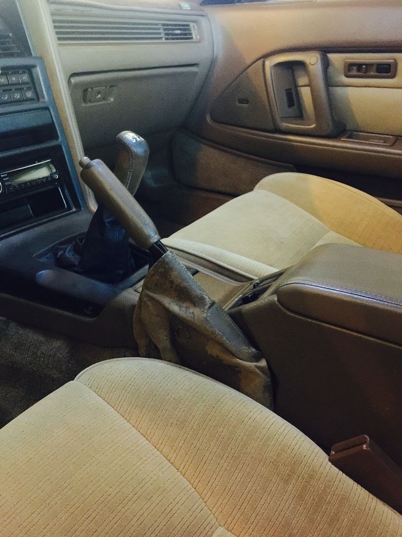

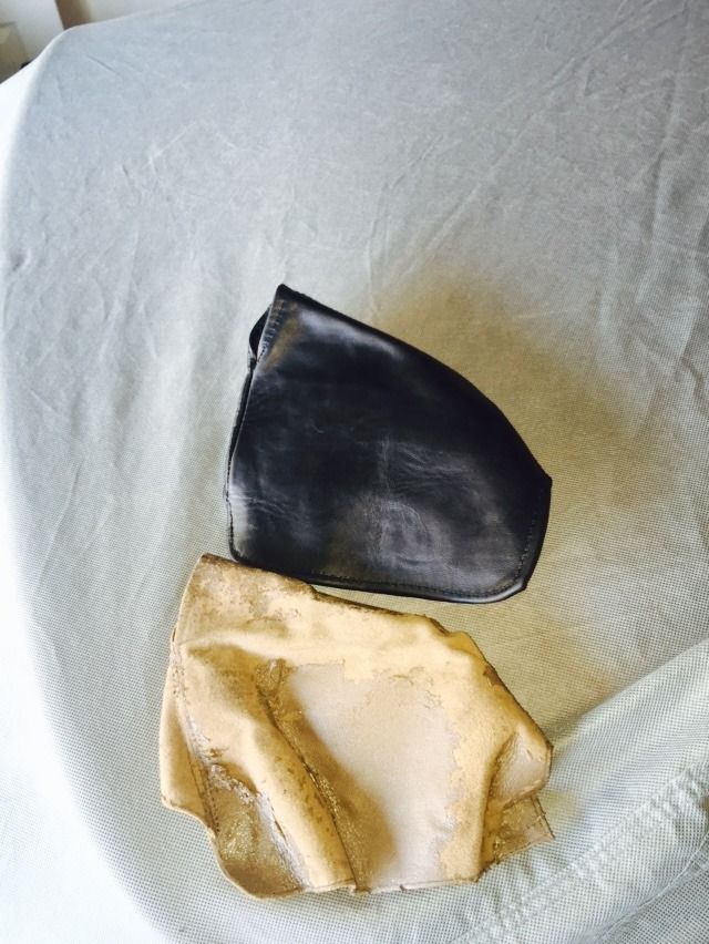

my new parking brake boot I ordered it from a Amazon dealer. I'm super happy with the quality it made from real leather no fake stuff. I'm liking the Black and Tan look I have started.

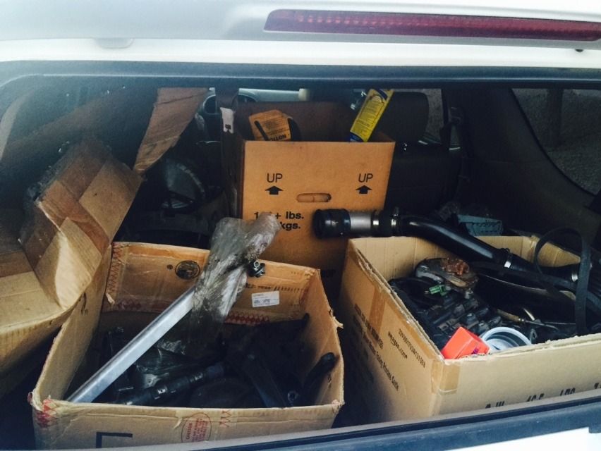

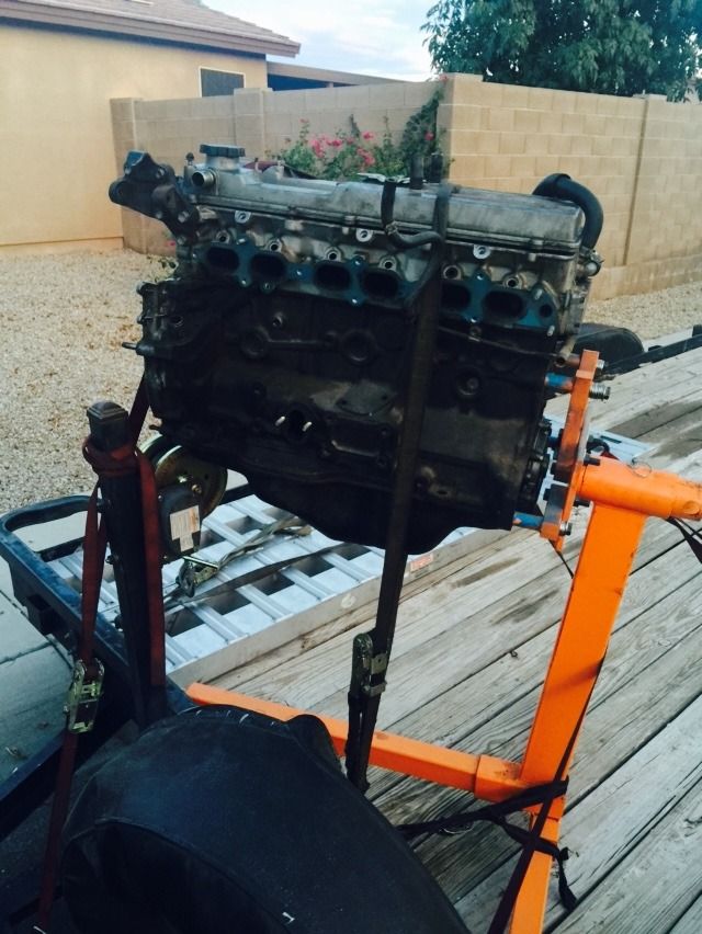

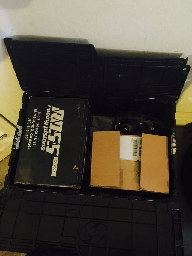

I went and picked up all the spare parts that came with the car. That include a spare engine and parts to rebuild the bottomed with forged Pistons.

Thanks guys, I am planning on rebuilding the extra motor with forged internals luckily it came with forged pistons and nice bearings so I just have to get some H-beam rods. to have a nice bottom-end built. I would like to have the head ported and polished before putting it on with metal gasket and studs.
What is a good torque for ARP head-studs I know ARP says 85 but I have heard 100lbs is a good torque.

Depends what you use as thread lube, iirc its 85lbs with the supplied molly grease or 100lbs with engine oil. ---someone correct me if thats wrong, been a while
One big reason you see different values referenced all the time.
