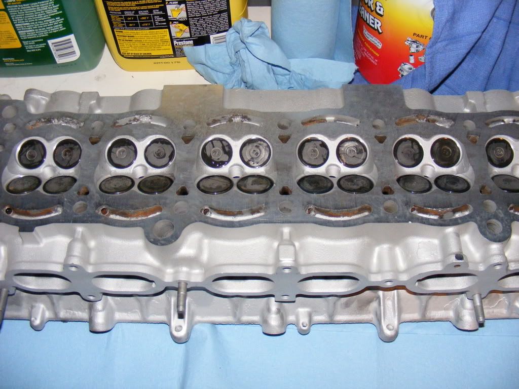

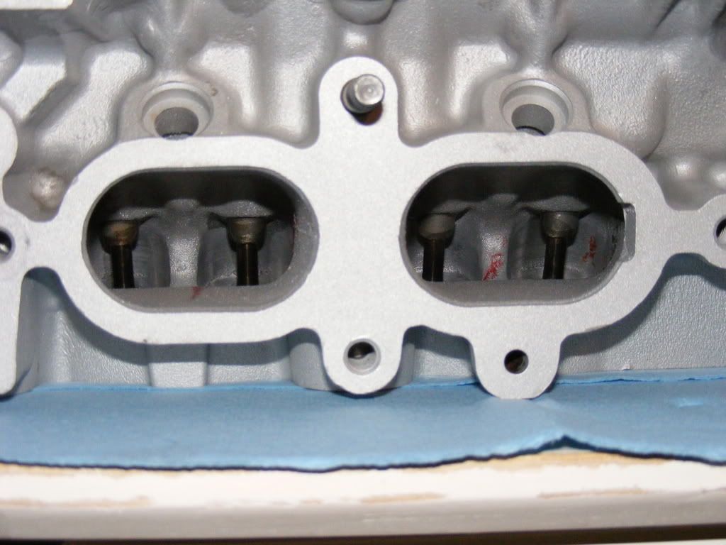

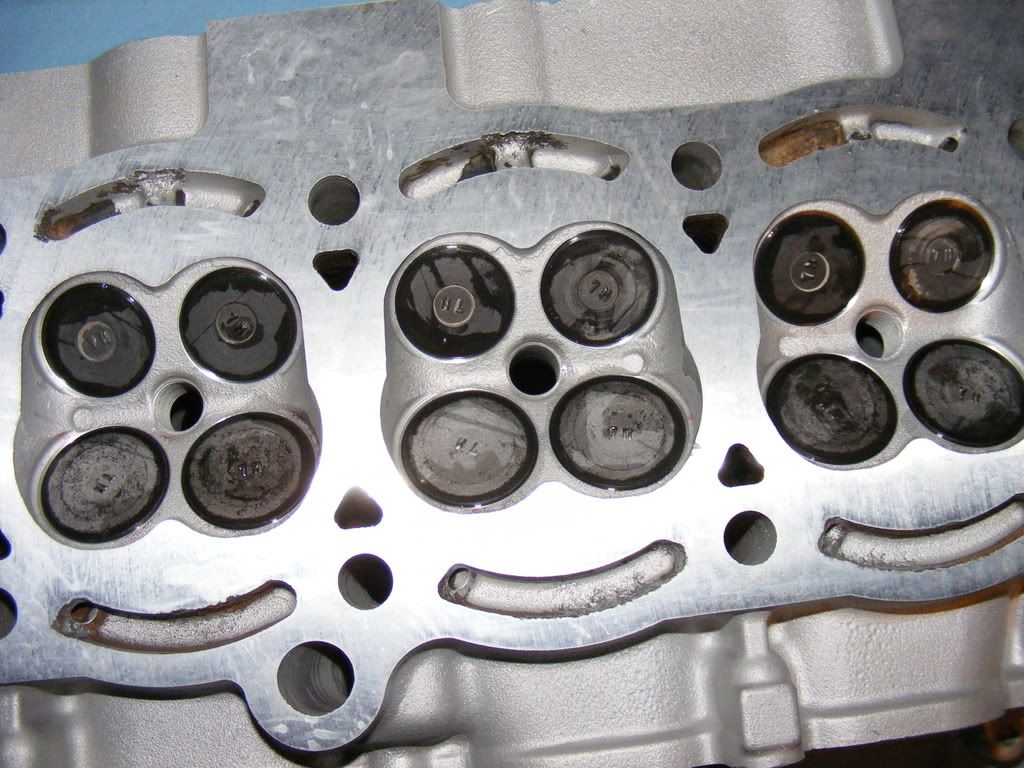

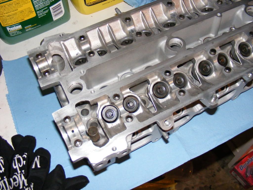

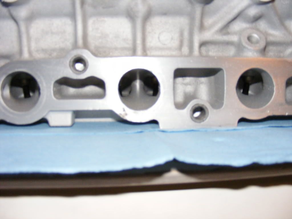

I Decided to just drop off the head, toyota valve seals, and Comp Cam Springs at my machinist. I also had him pocket port the intake side, timesert the ex side for 7/16 course threads, prep for MLS, and do a valve job and a before and after vacuum test. I really didn't want him to glass bead but it came out nice. :)
I punched myself in the face removing the valve seals on my junk head, and after talking to Ian (IJ) i decided i'll just pay someone to do all the work for me. ;)
PICS! (sorry if they suck)
This head had some bad electrolysis damage but for my intents and purposes it should be fine. :)
It came from a cressida. ;)

They could have cleaned up the combustion chambers a bit as you have some high spots.
Those exhaust ports dont appear to be of even diameter, did you measure them?
