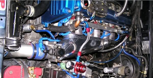

Pictures of it installed!!! Sorry for the delay but between a new job and my racing program I have been laying low on the forums with very little time. But here are some pictures I took of the FFI installed. Been running it for about a week and a half and works great! Hope you enjoy!

Haha, well it is definitly a mod for those who like top end. I improved high end reving fairly dramatically. But when you are talking about 20hp added to 400hp it is fairly hard to feel a difference cause it is crazy fast anyways..lol :evil2:

Does getting rid of the top runner end in better performance?
I know long runners is for low down torque and short runners for top end horsepower.
Cheers,
Roy
siman
Lifetime Ban
1,371
Murfreesboro, TN
The "veilside" design is made for top end performance ( saying that top rpm peroformance that is...not mph LOL)...
the design is made so that the air that is forced into the intake chamber via the turbocharger actually SPEEDS UP because the angle the rear of the manifold takes......
its kind of like a jet engine effect....the air just rams itself in the chambers rather than the long runner "torque" style.....
with either design, tube or veilside, you get added performance....but when it comes to style ( for me, though yes I believe in form follows function) the Veilside short runner design takes the cake and looks GREAT when polished.
