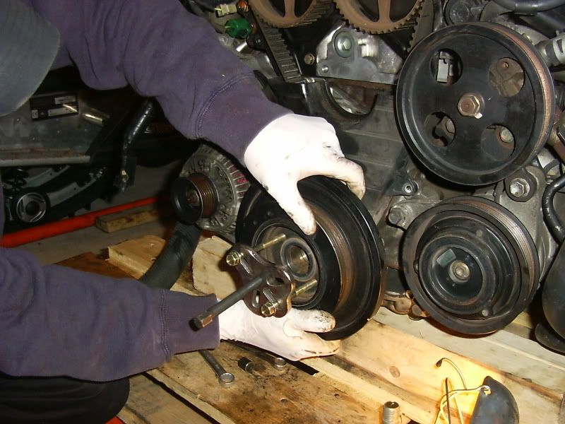

i just got my 1jz on friday :-D and i want to change the timing belt and water pump, and put on my light weight crank pulley which requires taking of the pulley obviously. what is an easy way of locking the crank to break the bolt free? i dont have an impact wrench, only a 2 foot breaker bar.

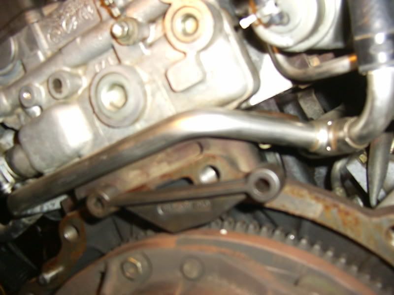

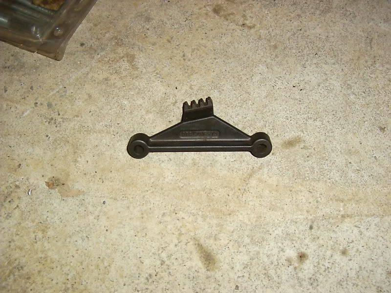

I used a Mazda sst that I had. It didnt line up with the starter mounts as intended but it worked out none the less. 4ft bar and socket on the crank bolt and 2 guys to lay on the engine so it doesnt flip LOL .. Check your dealer or a local shop they may have a similer tool stashed away. Hope it helps :)

heated up the bolt, came off with no problem.
i locked the engine by putting a tranny bolt in the block and a flywheel bolt in the flywheel and a wrench between both, work like a charm
