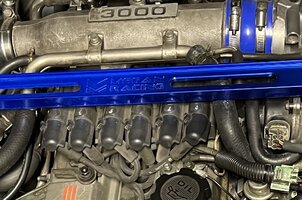

Here's a photo of the coil pack set up with the white stamped numbers visible. Left to right 1-6-3-4-2-5. The front row in the wire retaining clip is 1-3-4-2 and the back row is 6-5. Each retaining cap has dots to indicate which coil pack it connects to. I've noticed that they come in two colors, either dark gray or black. Those little retaining locks tend to break with age. The 1987 manual shows numbers for the wire routing, but the '91 online manual does not. Here's a photo showing the wire routing as well. The '91 manual has an additional one wire retainer for cylinder 6. I have (3) 1 dot, a 2 dot, and a 3 dot cap, all in black, that I can't use, but would trade them for a dark gray 1 dot cap in good shape.
I didn't know there's a plastic retainer just below the coilpacks. My old 87 only had the 3 retainers that are attached to the spark plug valley cover and were in pretty bad shape.
It's most likely my retaining caps were original. They are (faded) black and two or three couldn't stay in place and kept coming slightly loose but didn't seem to affect how the engine ran that I could tell.
There are 2 plastic routing clips that attach to the coil pack itself. There is one in front that you can see in my photo, and there's another underneath that is shown in the manual photo. I guess the whole idea of this routing scheme is to reduce the chance of spark induction in adjacent wires, plus it looks neat.
