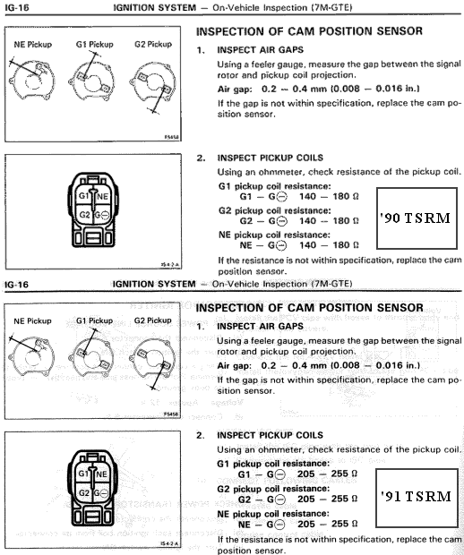

I just tested my cps because my car is misfiring... and the tsrm specs said resistance should be between 140-180 but is at 183-185.
here is the test I did
I know that its not off by much but could this be my problem?

dont worry about the resistance being slightly out. I have 3 CPS's here that are all in the high 200 ohms range and they all work perfect.
Yes resistance can become an issue with a CPS and it functionabilty, but not until you get up over 1000ohm range from tests that I have done.

here's some cps info for you. different spec in '91 tsrm than '90

there is nothing wrong with your CPS. Like I said in my first post, the resistance is not something to worry about until it gets high, about a 1000ohms. I have tested this several times. Plus, a CPS problem would not go away or get better when under boost or WOT. Heres a thing to check though that is related to the CPS, Check it just as you would at the CPS for the resistance, but check it at the ECU, this way you know what the ECU is seeing. Wire does build resistance as it ages. It shouldn't be much more then a few OHMs high if any at all.
