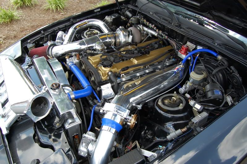

Great work Seth, love the HQ pics. Just a question though as i've been staring at your manifold for the last half hour.It looks to me like turbo 2 will become superheated after a few runs or am i thinking of it all wrong?
Amazing work either way and will this become a product people can buy from you?

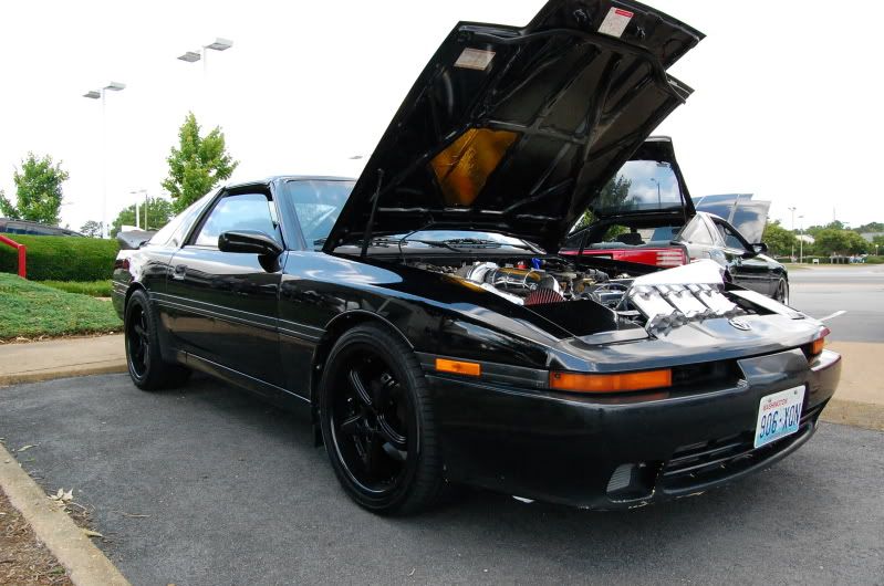

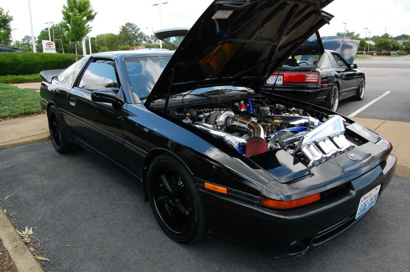

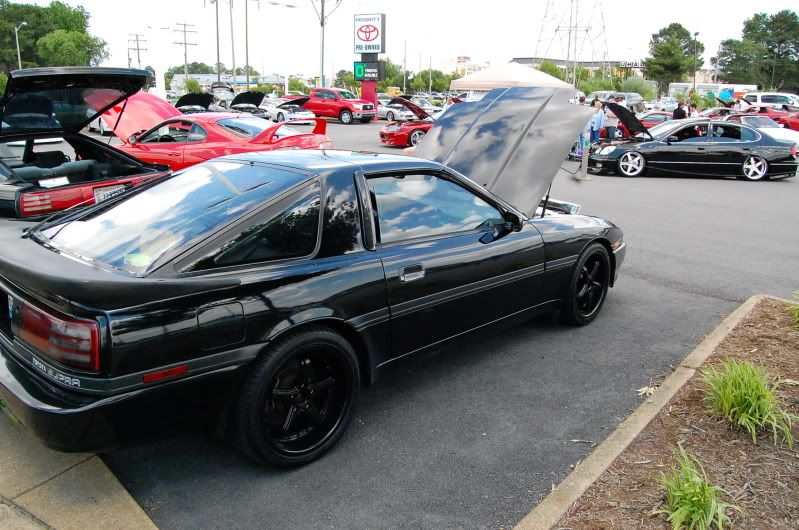

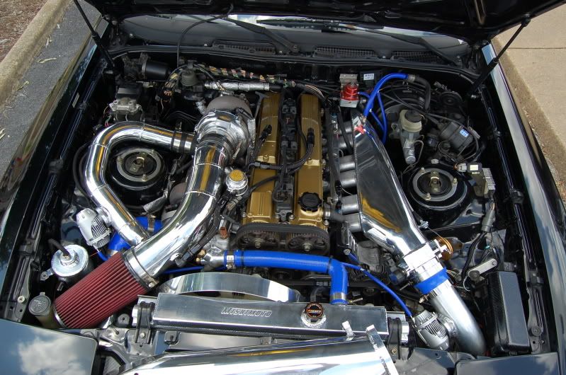

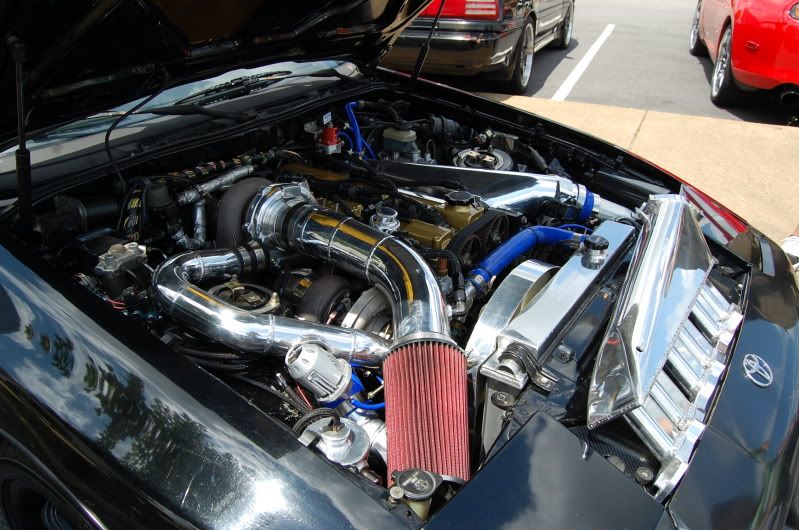

It's alive!!!
Pulled an all nighter literally was at work at 7AM Friday and didn't leave the shop until 7:45 AM the Sat morning when I drove the car home to wash it and head out for a show. Motor was dropped in Thursday night, started it for the first time about 4:30 AM yesterday and drove it around 5:30 AM! Gotta give thanks to my girl Ana for bringing me dinner a few nights and even helping guide the engine in for me!
Here are pictures from the show:
Thanks for the support guys!

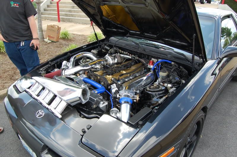

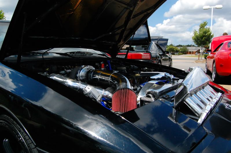

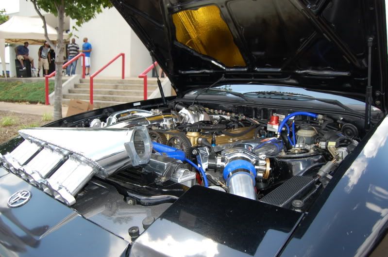

Is that a mid runner intake you are running on that?
Whats with the manifold sitting on the nose of the car lol
sethron71
Authorized Vendor
Jul 19, 2005
871
Las Vegas, NV
www.SethIngham.com
Yes that is the medium runner manifold Dan,
The one on the hood is a short runner, I will PM you this afternoon about it.
Supra_Villan the exterior is stock, no fender modification, wheels are 18x8.5 +35 and 18x10 +30 I believe. They are TSW's powder coated satin black.
Thanks,
Seth

Lookin' good, Seth!:) I have a question, though: How did you get your cams lined up and timed properly without the upper rear timing cover? Keep up the good work!
