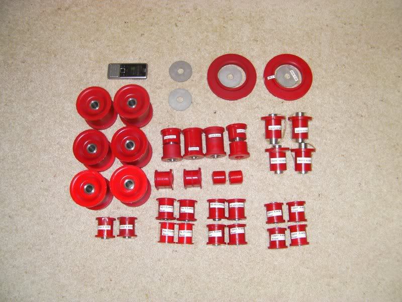

I bought EVERY bush for the entire car & they came labeled. Don't know if he would still do it for front / rear kits on their own. It would be pretty easy to figure out in that instance.
Here is a picture showing most of mine:
My steering rack bushes are already in the car, so not in the photo. I will also be getting rear upper spring perch poly isolators. Only fronts are supplied in the kit.

The holes in the washers are way too big and don't centre, the above "mod" makes it an idiot proof install as you don't need to try and centre them by hand and hope they don't move as you tighten the nuts.
