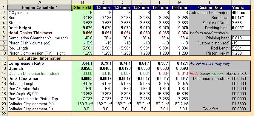

Just get a thinner headgasket. You do the calculations, then call someone. Cometic will make any size you want. Call Eric at HPF.

stock HG thickness squished = 1.2mm.
there is a TON of stuff you can do to the engine, most importantly being upping compression ratio. shaving the head to up CR isn't the best idea as the combustion chamber gets all wacky then. unfortunately, with the amount of $$ you'll spend on custom headwork and pistons, you could have turbo'd the car and been making 2X the power (not trying to start a war, just giving facts.).
