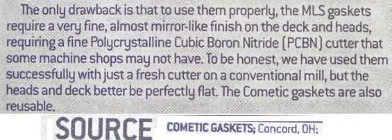

OK you are referring to Cometic recommending an RA of less than 50 and other recommending something smoother & IIRC one of the others recommends an RA of less than 25. I got my figure for Cometic's 50 from one of their reps on the phone. I read the 25 for the other maker by a member once.
Now just because a manufacturer recommends a different number does not necessarily mean that it is more forgiving or less forgiving. The RA manufacturers suggest is based on how they see it as well--opinions vary & marketing tactics vary. One may feel that recommending a smoother surface is better because more successful applications will result. Another may recommend a higher max RA because it would benefit their sales to sell to those that can't get as low as 25 RA.
Now you SHOULD get an RA of less than 50 for a Cometic. If you don’t, you are taking you chances. Here is a bad example: It is just like if someone said I was speeding @170mph & I got away with it. That does not mean that if I (or you) will be able to get away with it if I (or you) try the same thing. Now doing the speed limit will guarantee you will not get a ticket and it is not chance then to get a ticket or not. Those that got away with not prepping the surfaces properly ARE lucky if they have no problems. Do it the right way & be safe. That was a bad example but let's not start a speeding topic here.
Says right there, this is what we recommend & this is what we have gotten away with. Big difference between those two.
