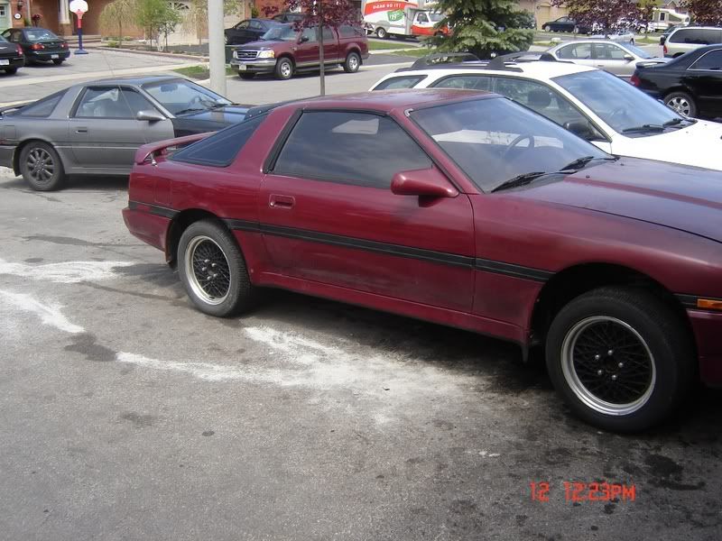

Standing proud on jack stands, it is my pride and joy to an extent that every time i wake up and see it outside, i am shot with a rush just to drive her again.
Can anyone guess whats happening? ;)
Well story of my car was i bought it for a steal locally, and it ran and pulled strong! So i was happy when i purchased it... until 1st oil change.
I opened the oil drain, and stuff started SLOWLY dripping out. the oil was so thick, you could literally make it stand up by itself. I feared the worst, so i put in some 5w30, but yep. start up, i had the knock. Sucked big time but what else could i expect.
so here is where i stand as of right now. It will be pulled today hopefully when i get my load leveler from a local supra owner. Now some of you may wonder when this will be up and running after the engine will be rebuilt, but i already planned for that one ;).

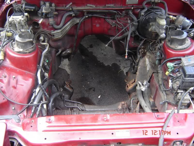

engine was ready to come out... then my engine hoist wasn't working. it had no fluid left in it. owned. hopefully it will be out tomorrow, the tranny is sitting on 3 jack stands and 1 hydraulic lift, engine just sitting there on the mounts. so nothing until tomorrow... GAY.

What the hell?!?! i got robbed overnight! :biglaugh:
well all went well except for minolry bending my rad support :(
not too bad, i will paint it myself regardless.
4x4 action ftmfw! :D (brothers 1jz "2 tone" car in the background :naughty: )
Question for everyone, does anyone roughly know how much to replace every hose under hood? i have a lot of new ones anyway, and im ditching ac, just does anyone know how much to replace the ones that go to the power steering reservoir, coolant hoses, vacuum etc. it would be nice to know what to prepare for :biglaugh:

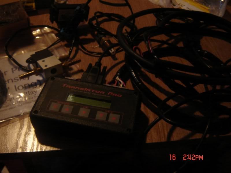

some goodies came in the mail today :D
courtesy of conundrum07

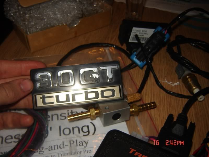

and my super jdm tyte 3.0 GT badge
courtesy of suprra_girl
btw does anyone know how to get a chrome finish on the badge again? its peeling a little bit.

starscream5000 said:
Yep, Wal-Mart has the stuf in the auto section or in duplicolor brand too. I suggest clear coating it too. Nice build thread so far ;).
heh cool, and thanks for the compliment! i hope it goes as scheduled, which we all know it wont ;)
