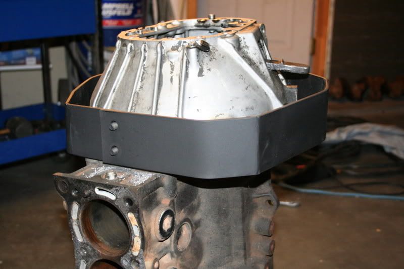

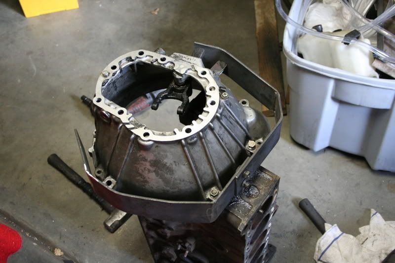

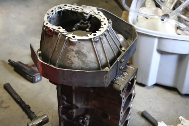

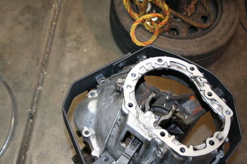

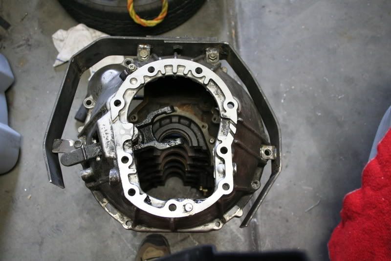

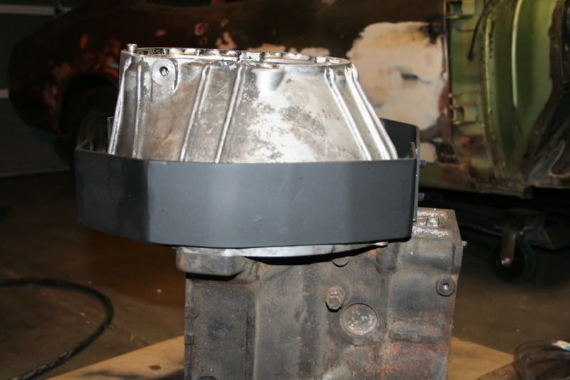

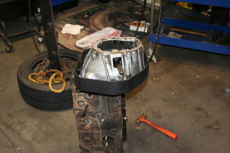

Just trying to get get the car leagal to compete... anyway here are some pics of the clutch scatter sheild I'm in the process of building ..
Just thought id share
