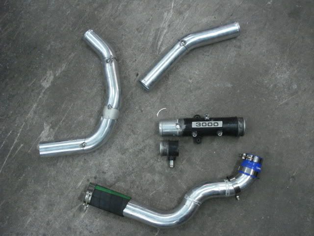

Started with building a quick/easy install mount for the inter cooler to get it right where I wanted and not jimmied together.
Cut and fit the piping then tig welded the seams. Used as little couplers as possible to reduce the tendency for a boost leak.

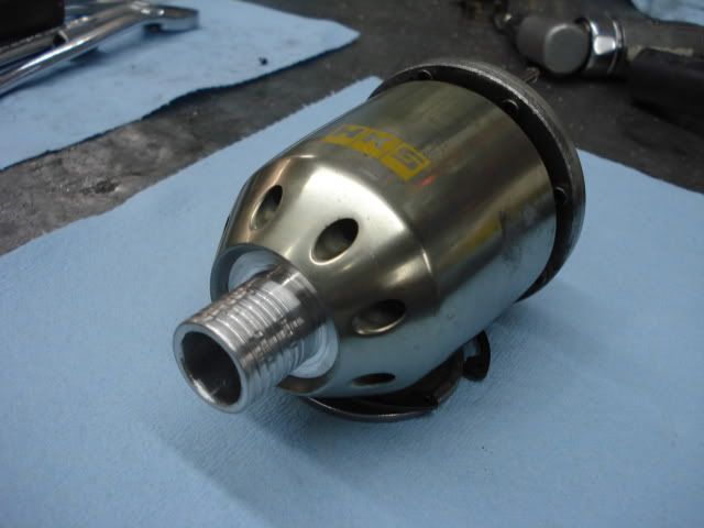

Made myself a recirculation fitting for the HKS SSQV so the car would run properly (bugs me when shit doesnt work right)

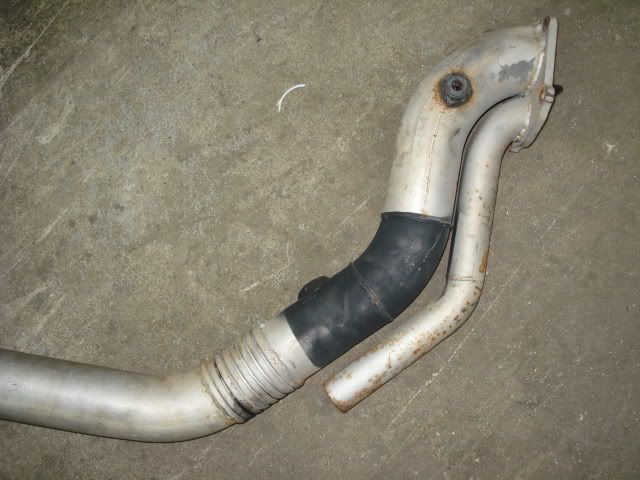

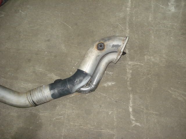

Modified my BIC divorced DP into a recirculated divorced pipe so I can actually pass DB ratings at auto cross and other events that have them.

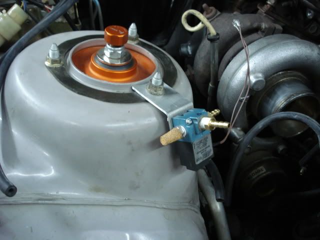

Installed AEM Tru boost into car, yay for now more ghetto manual controllers.

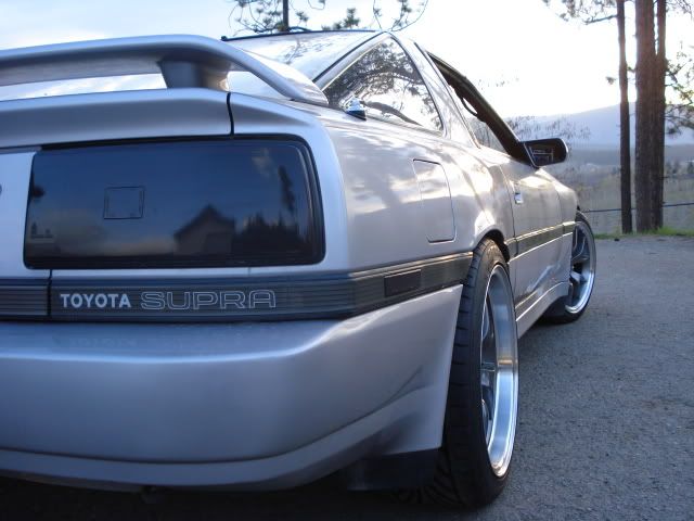

New rims and tire I picked up from the Portland Swap meet. Getting the car to fit these wheels was pretty time consuming. Rolled fenders all around and the rears have been pulled a lot. Overall fitment is very flush with no rubbing or clearance issues.
18 x 9 +27 fronts with
18 x 10 + 21 rears
17 x 10.5 +27 with mickey thompson street radials mounted

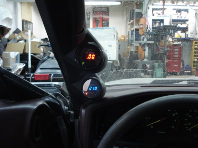

Loteck pillar pod installed and cleaning up the interior a crazy amount.

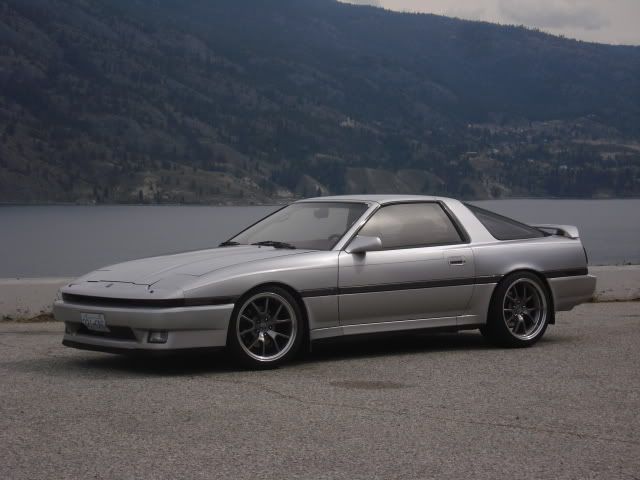

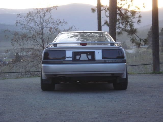

Picked up my 57-trim CT26 from washington today and snapped a pick in Pentiction, BC on the way home. As she sits now.
