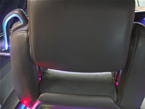

Few other bits too - sorry slightly off topic but, still lighting anyways!
