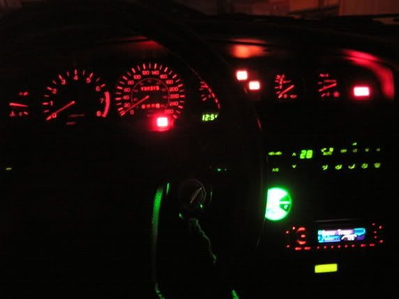

i changed mine to red..... you need four 194 and one 74 to change the gauge color. blue looks ok but IMO red is a lot better choice ill take a pic of it tonight and see if my computer will let me post it. any auto parts store should sell them however the 74 is a BIOTCH to find in any color its easier to just paint it. flame all you want but it works

mine are red led's. :) they look really good. i got them from www.superbrightleds.com . (the five-way LED's) very even light distribution.
HOWEVER, keep in mind that if you convert them to red, and you're pre '89, you won't be able to see the redline at night. (so switch out the gauges for '89+, or at least the tach).
doesn't really matter to me, as by mid summer, i'll have a custom defi gauge cluster, save for the speedo and tach. :)
