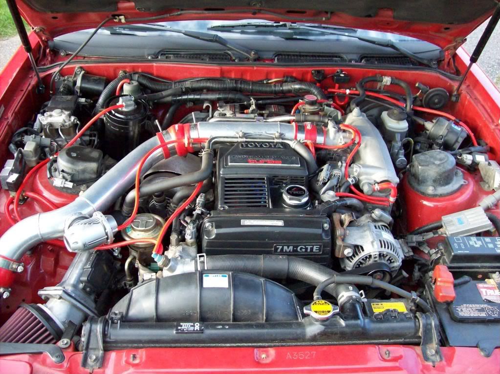

interesting test results, based on what you have posted on how your car is set up. How about a good pic under the hood showing your bov area ? Pic might help us see what is up and get this figured out...

No, I only have one blow off valve. But I have ran my car with recirculated, and vented just to see how the car reacted. Once I went to Lex/550/CT2657/afpr it didn't matter what I did (recirc or vented) the car would sometime stall if you are in boost and let off the gas (happens pretty rarely). Back on the stock turbo/fueling/metering it almost never stalled.
engine bay shot (old) but still the same BOV position - it is vented in this pic

Ok I have to agree with Supra0089 after reviewing the pics in recirc and vented mode. Get some sort of piggyback. If you get a emanage, you can vent the bov because it will compensate for it.

You do realize the two engine bay pictures are of different cars right? You guys can continue to help the OP but I don't need any help regarding the stalling. Just giving the OP my experience so he can draw his own conclusions about his car.
