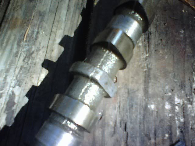

ok here is a pic of my old camshaft. for right now. because i have not started to break down my engine yet. now this one is precut on the round piece in the middle of the lobes. now the new ones are completly round making it impossible to get anything to the head stud nut.

Nomad707;1176423 said:
then take the cams out... it's seriously not hard..... and only takes 5 minutes of your time more if you already got valve covers off..............
uh i dont know about you but takin them out is quick but retorqueing them back in is a pain in my back and doesnt take 5min to do. there are to many damn bolts. and after 3 headgaskets you get tired of takin them in and out. plus i planed on takin them out before i grind a place on them.
