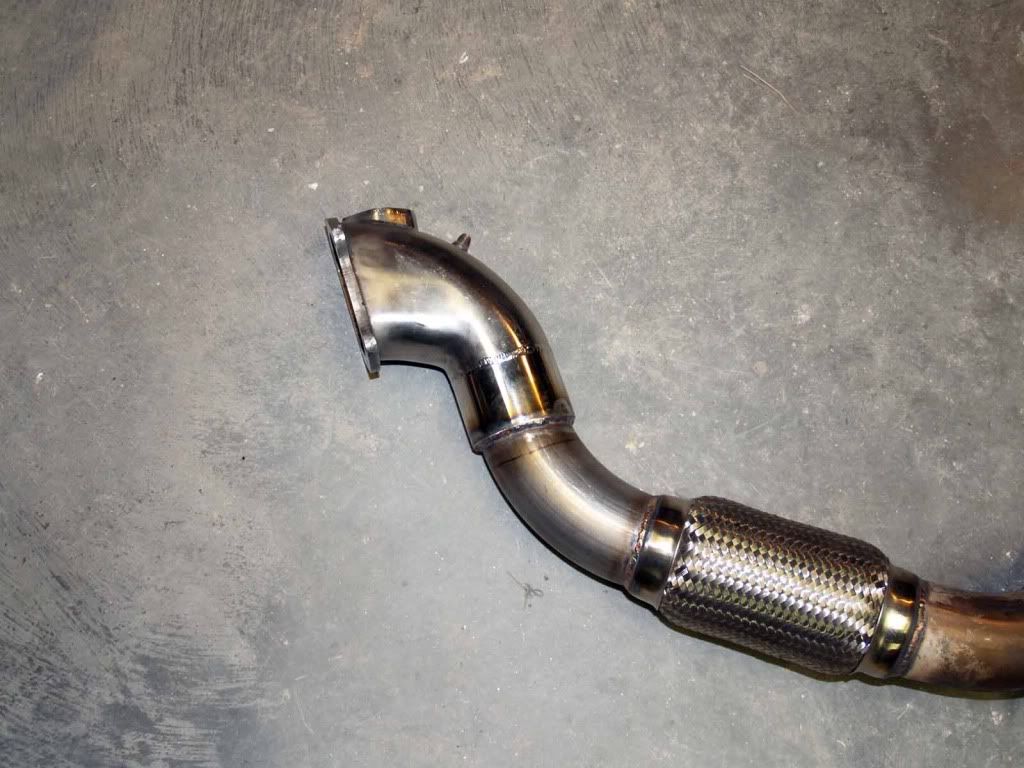

First up is my newly designed downpipe. The megamouth is huge and necks down to 4". I couldn't readily find any 3.5" to make a good transition so there's an edge; but, compared to the previous section of 2.25", it should flow much better.

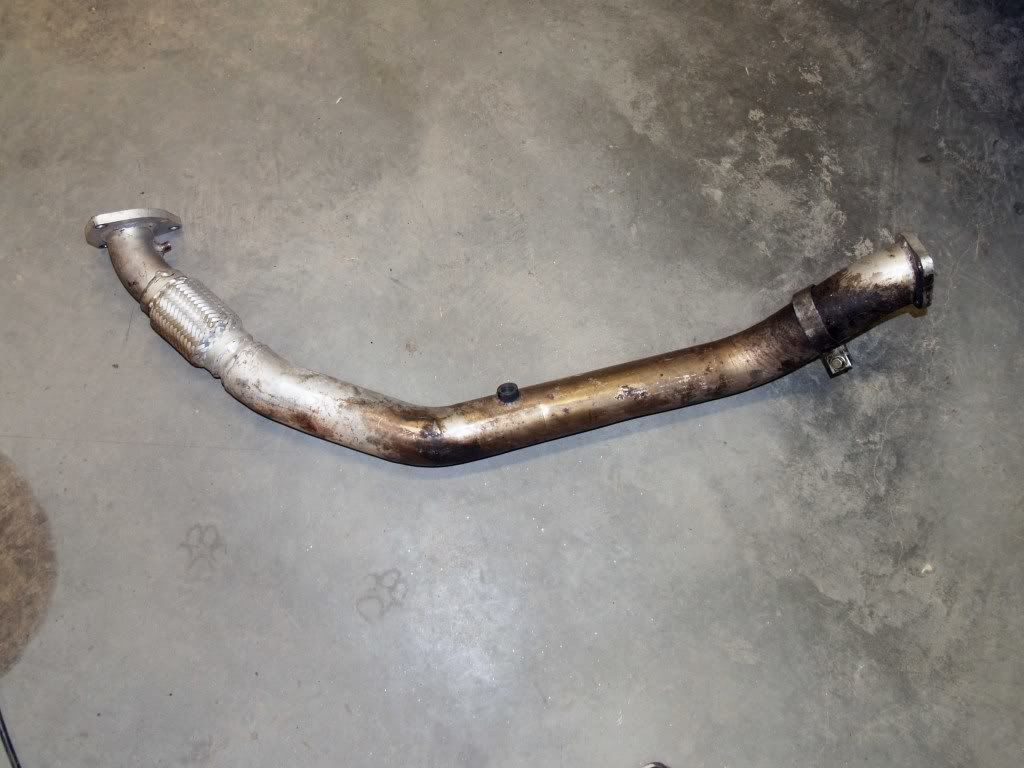

Note the relocated EGT Port... (for reference, the original one is posted below)
Original:

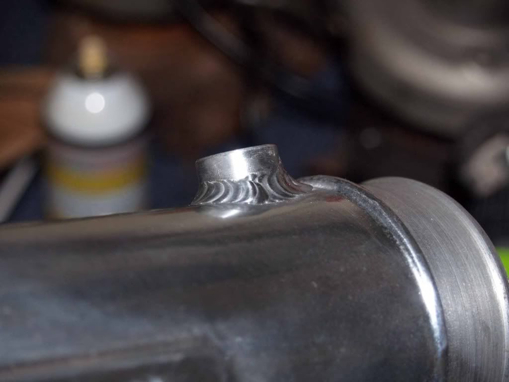

...and what's this? Yep.....it's the water/meth nozzle bung. It's a bit too thick which will restrict the spray pattern of the nozzle. It'll have to be reduced. I'm thinking that it may have to be taken off completely because the 3k pipe is thick enough to tap there. My mistake...

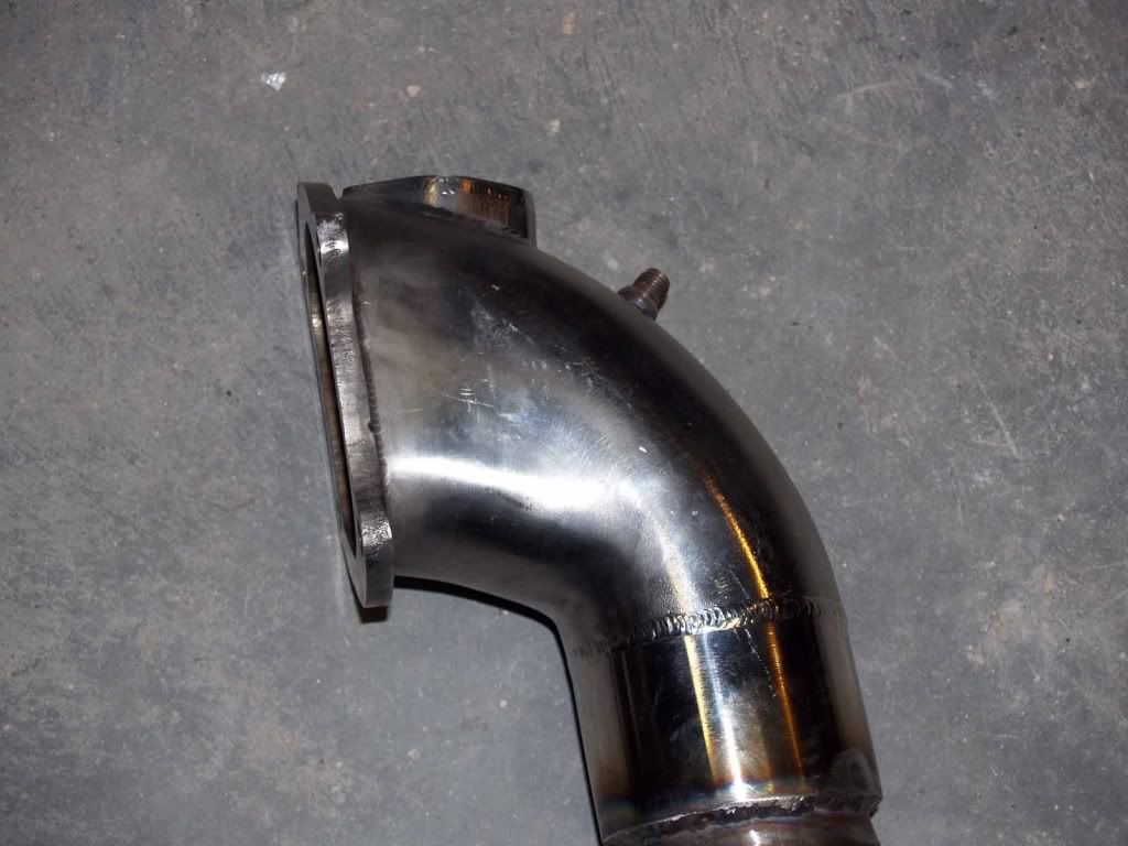

I trimmed the Meth Nozzle bung and installed the 3k pipe for a test fit of the nozzle and the meth line to make sure there aren't any clearance issues.
I like its location because it's all stealthy like. He he...:evil2:

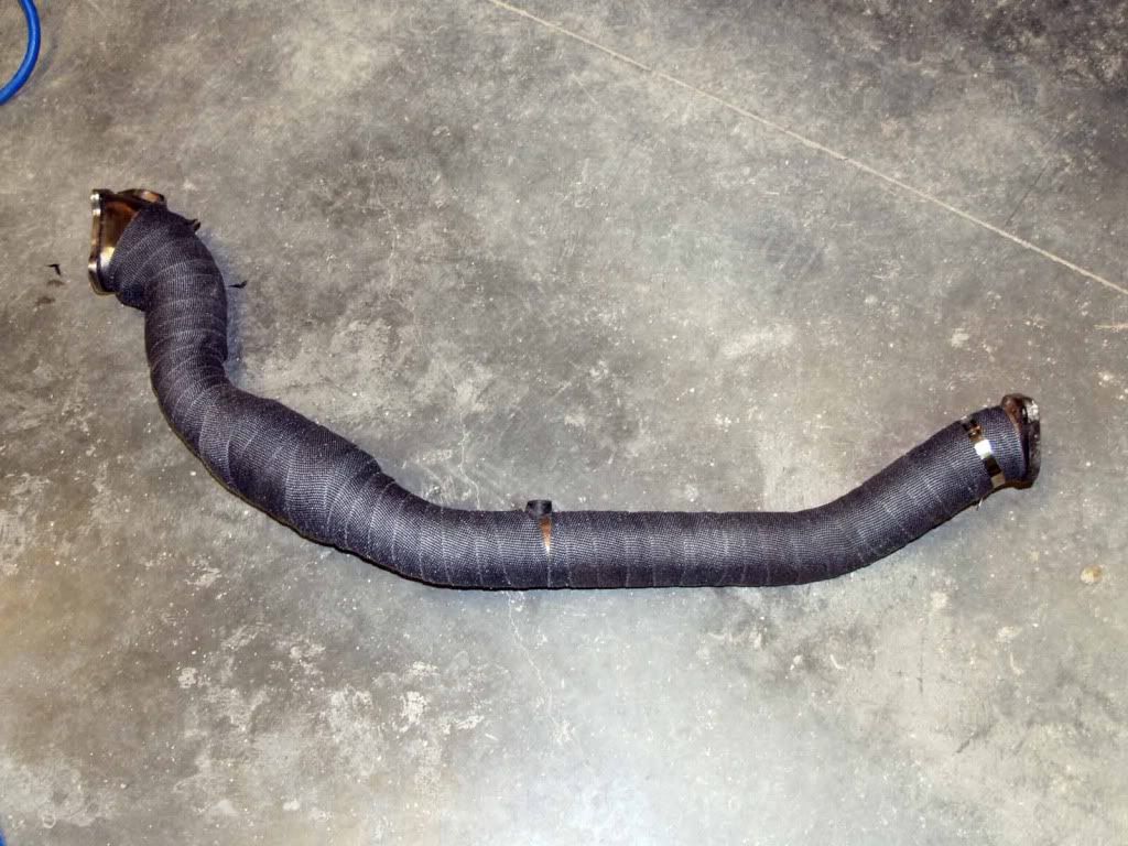

Here's my wrapped downpipe. This was NOT fun to wrap. Not at all...in no way, shape, or form. I'm glad it's done! ;)

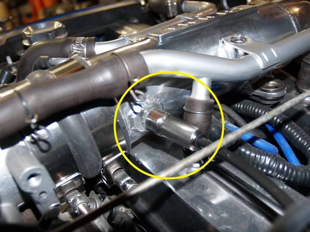

That said, here is the new intake pipe matched with the new Weapon R Filter. Sorry for the dirtiness and wire clutter. I'm re-routing the O2 Sensor wires because I'm tired of repairing them from getting melted via the stock routing.
