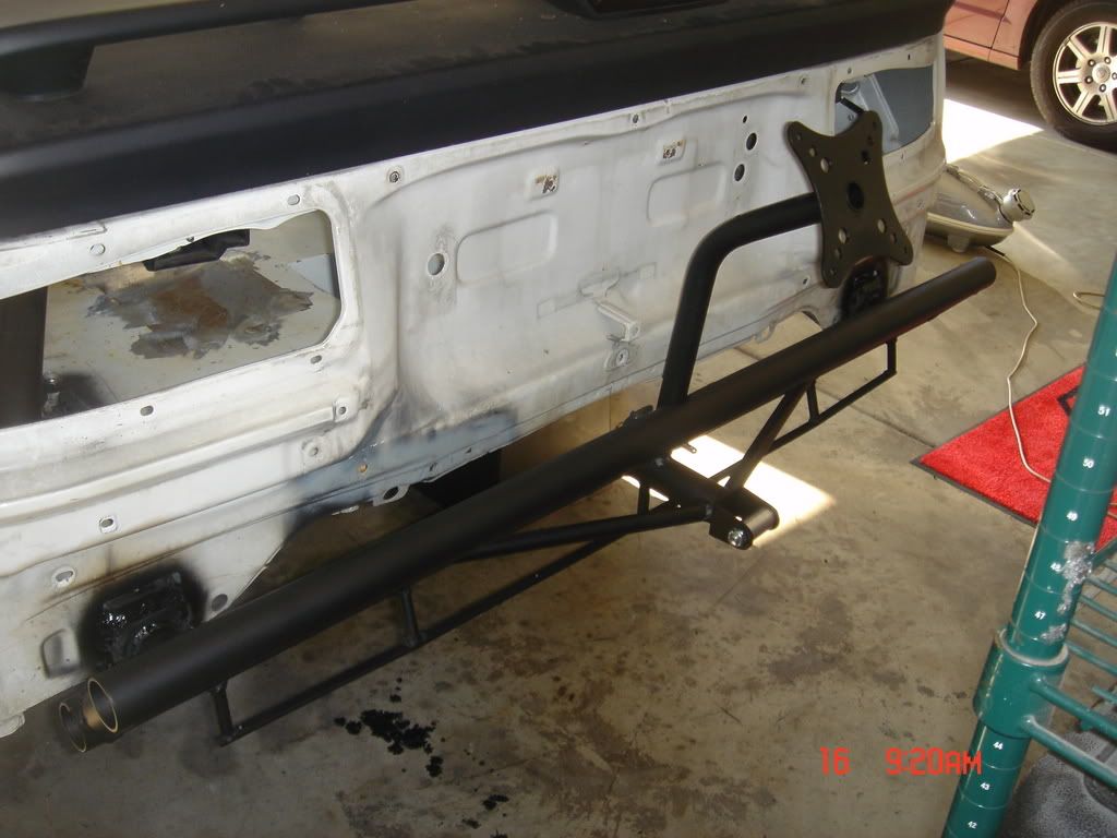

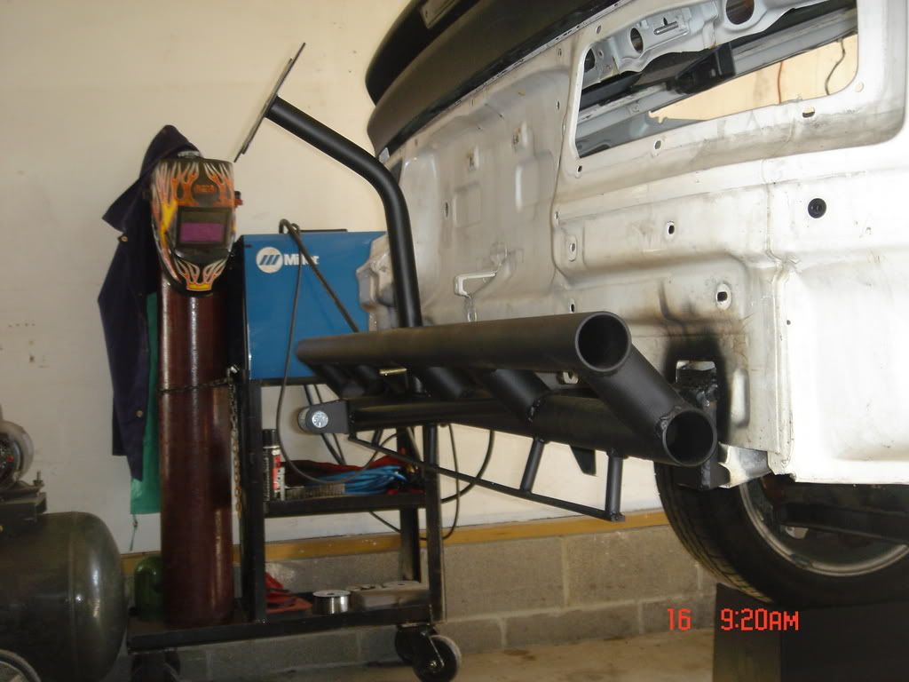

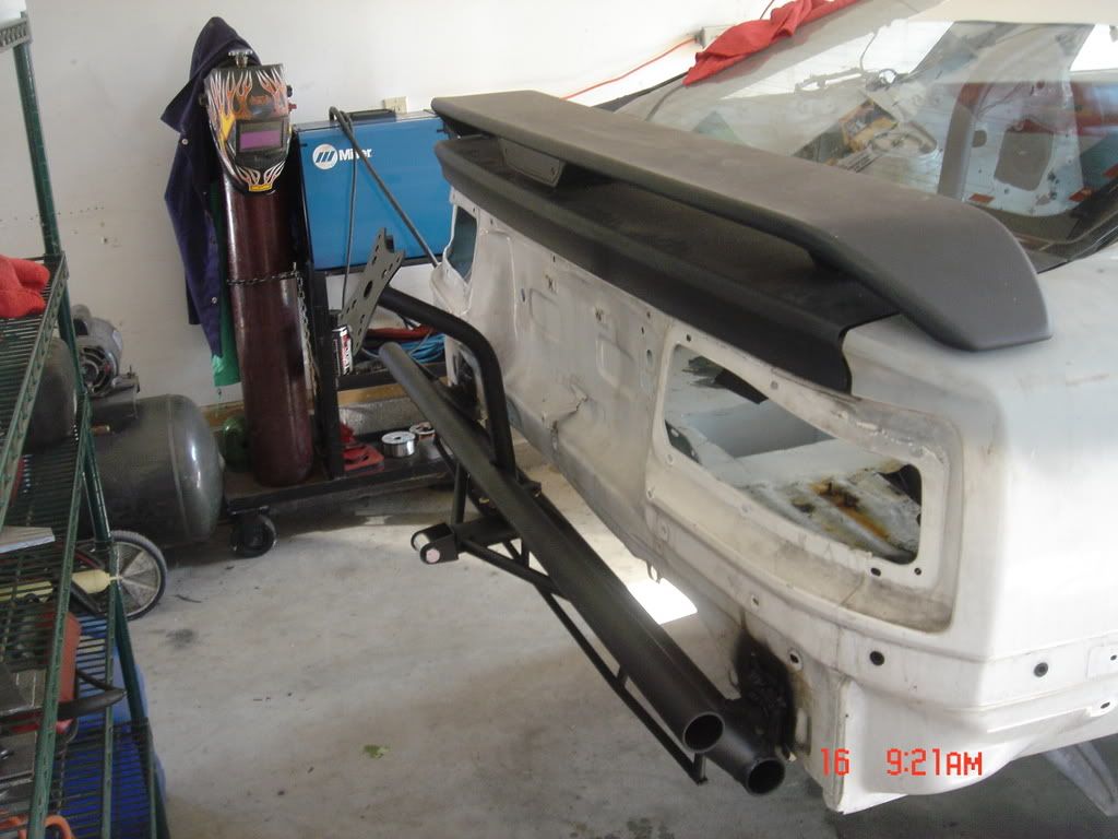

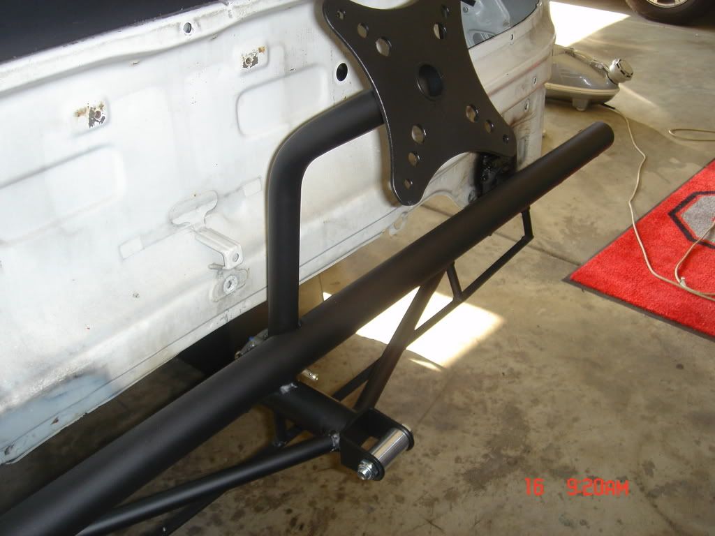

Cage is finshed and the chassis work is almost done.
wesbeech
Beech Performance Motorsports
Feb 26, 2006
1,022
Akron Ohio
Ok well this is what i started with a pre bent s&w 8 point cage.
38 feet of 1 3/4 dom tube
My tube bender.
And this is what i got.
wesbeech
Feb 26, 2006
1,022
Akron Ohio
And here is the chassis work. Its almost done but when the shell is on the rotissery i have to box the rear frame rails for strengh and to be safe. And one i box the rails im gonna make a mount for the nice alumnium towhook im gonna make. The chassis is being built nhra legial for 8.5 or slower just cuz im sick of doing shit 2 or 3 times.

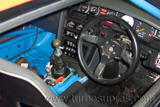

Looks great, now do Group A style bracing in the front. ;)
Click to enlarge:
Look down near the floor where you calf would go on this RHD car:
And to the shock towers:
