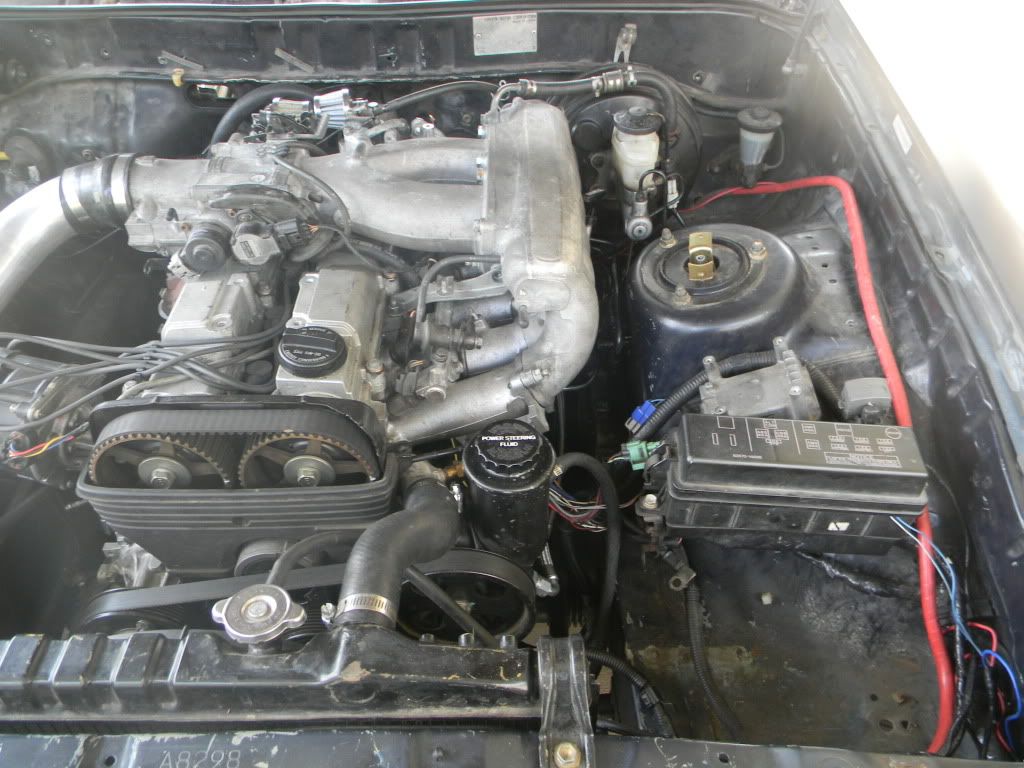

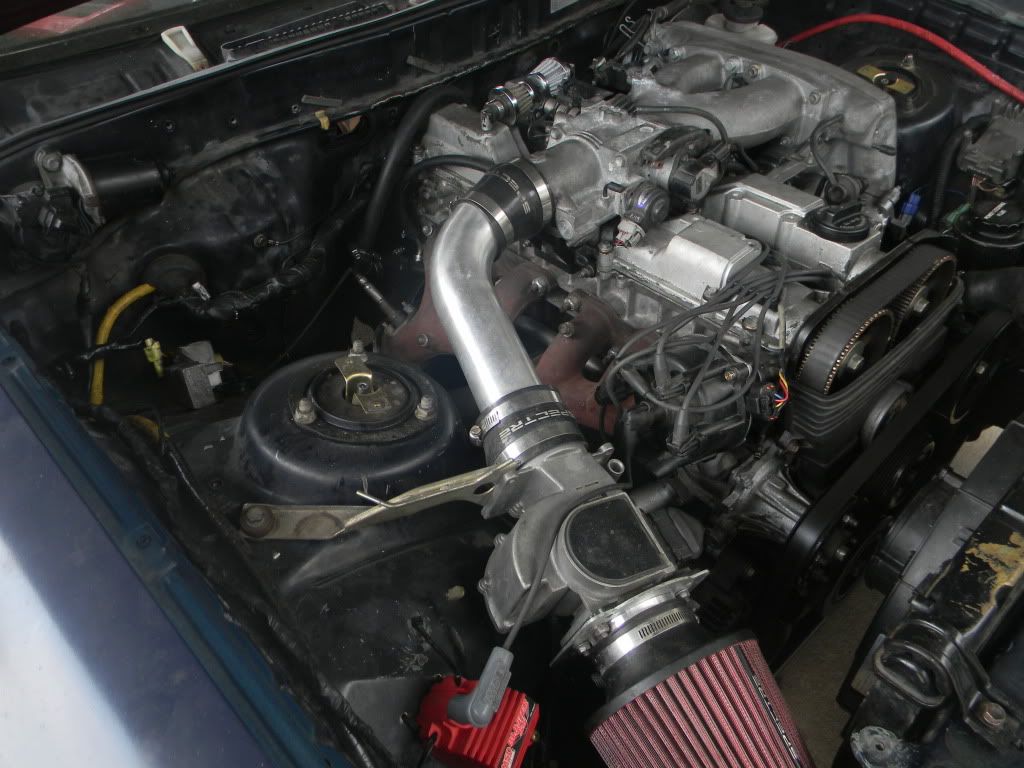

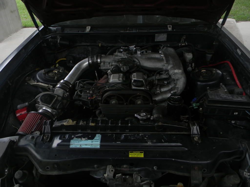

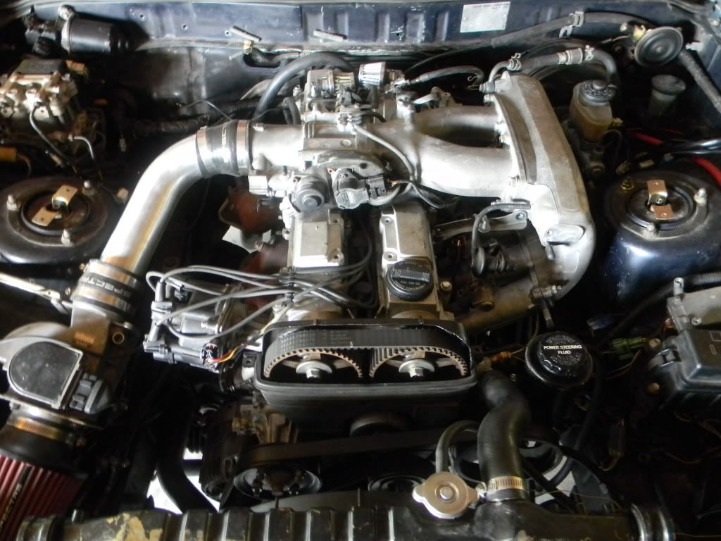

I completely rebuilt the motor. new bearings, seals, rings, and arp studs for the head. Motor went in like butter.
---------- Post added at 01:54 PM ---------- Previous post was at 01:49 PM ----------

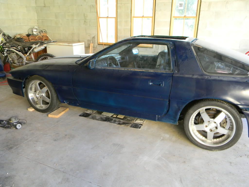

Started sanding and got a few goodies in :)

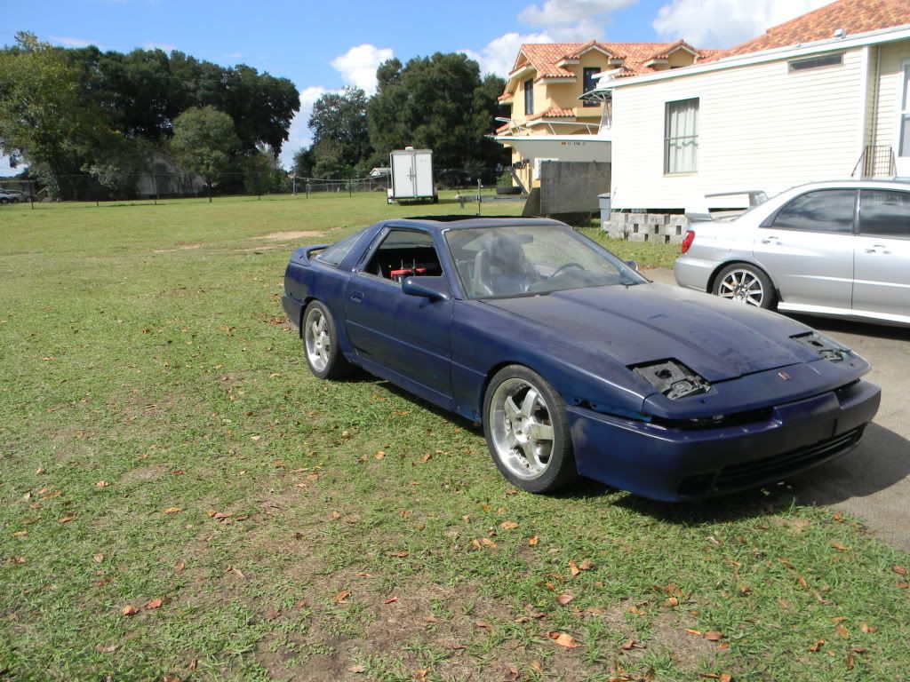

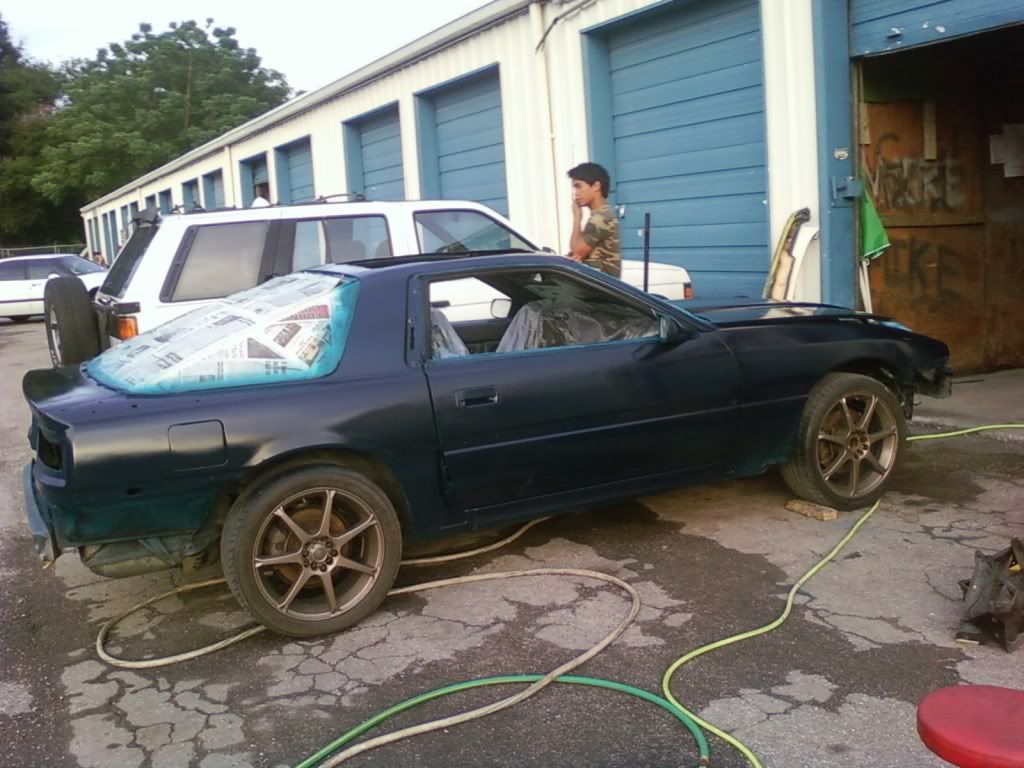

well heres the pics right out of the "booth" lol i know it doesnt look that great but it is better than banana yellow lol
has no clear coat, and no that is not me in the background.

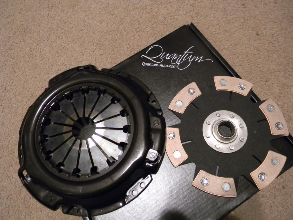

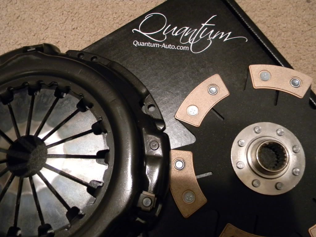

I am pretty sure it will grab....lol Give these guys a call at Quantum Auto! they are great people, wont screw you over, and sell a great product! trust me i know them personally.

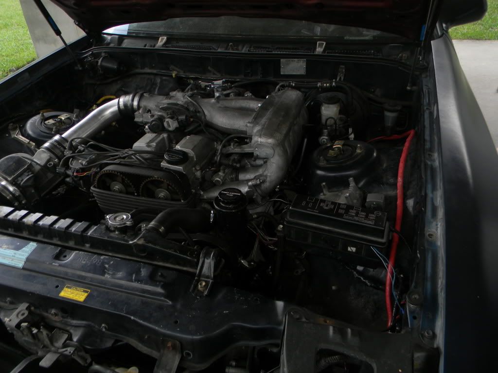

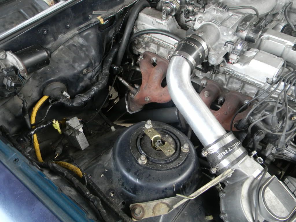

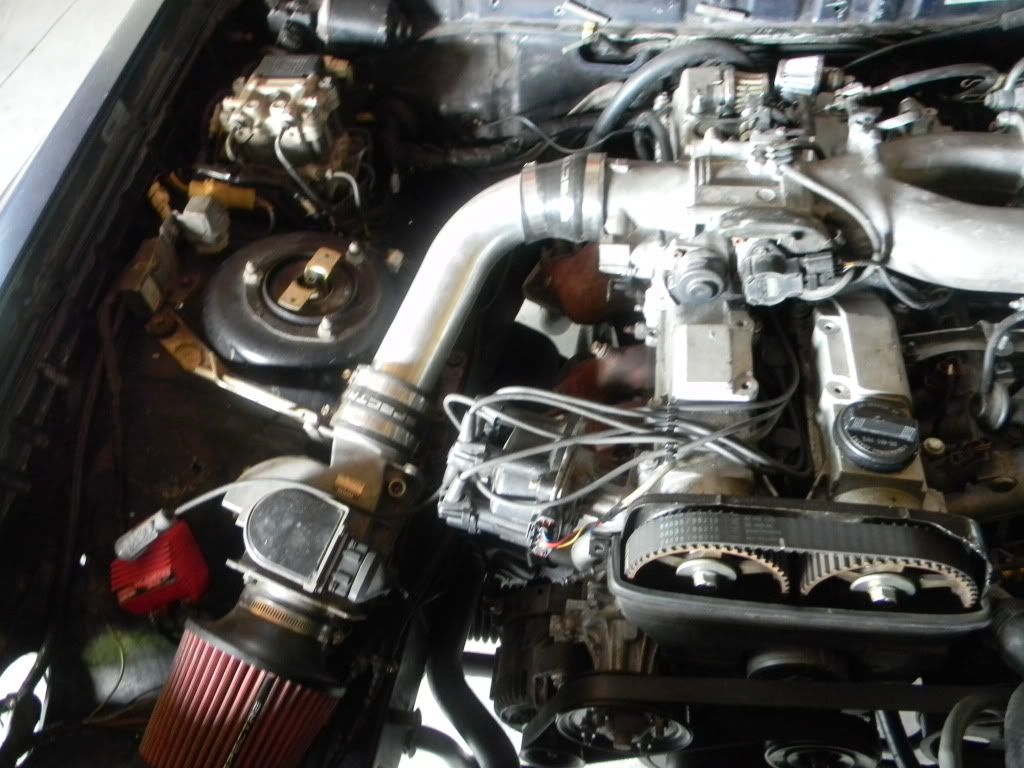

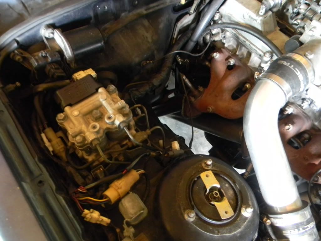

picked up some non abs brake lines to delete my abs and im going to tidy up all of the cables.
^BEFORE

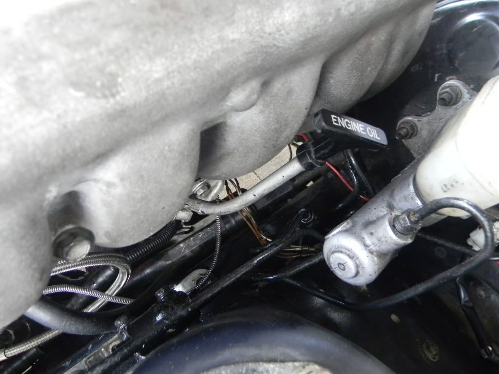

Well, i picked up some non abs brake lines from the salvage yard. ALL YOU NEED ARE 3 LINES!!! Cost me about $5!!!! I also cleaned up some of the wireing but im not finshed cleaning all that up yet as well as i moved the fuel pump relay to where abs unit used to be so it wont be seen as easily. here are the after pics.
AFTER
Hope you guys like it!

Can still put the relay in there. Or just buy some or the part that cover it. Tere is a lot of space in there. That's where I put mine.

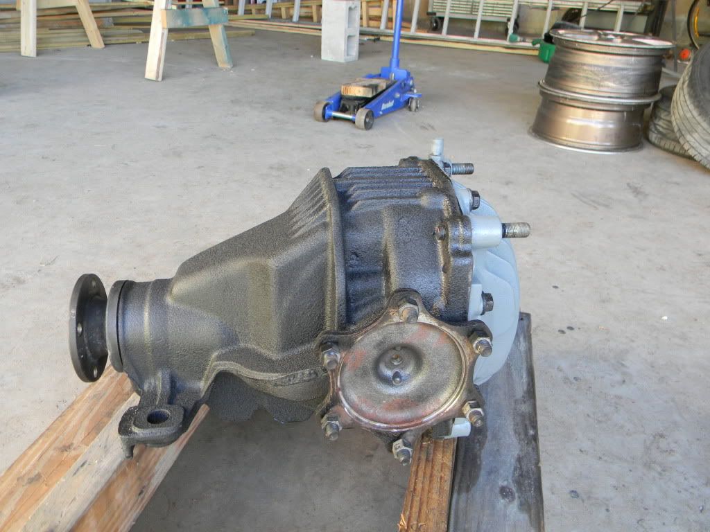

alright thanks will do. next step in the build is to rebuild my diff with the weir performance kit and a hydro ebrake. either using a staging brake or an actual ebrake. havent decided yet.

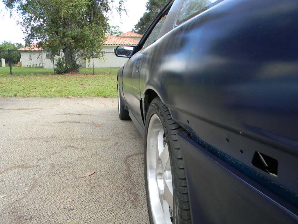

^No on the outside it was not to bad, driver floor board had holes straight through, fender wells were falling apart, obviously the spare tire area was shot, and lots of rust on the undercarridge and rear subframe. and i dont have good fab skills or welding skills. i can somewhat weld but all i have is a stick welder and you can use that for this lol Thanks guys

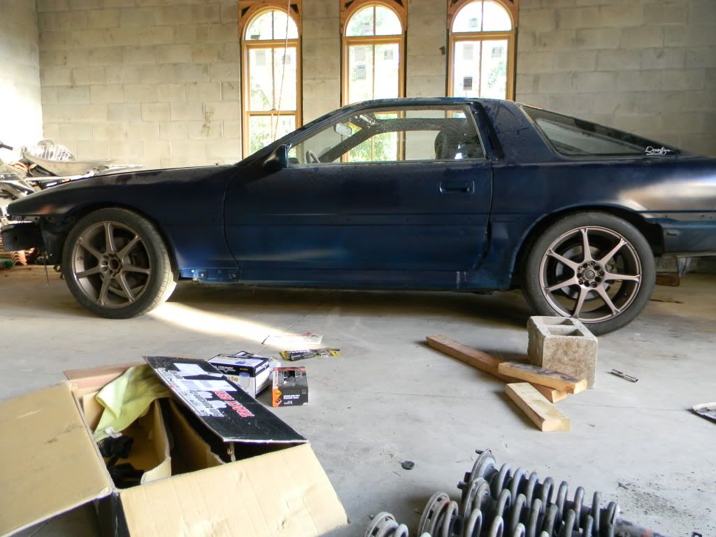

Man the car has come pretty far lately here are some updates!!!!!!!!!!!!!!
COILOVERS!!!!!!!!!! :D

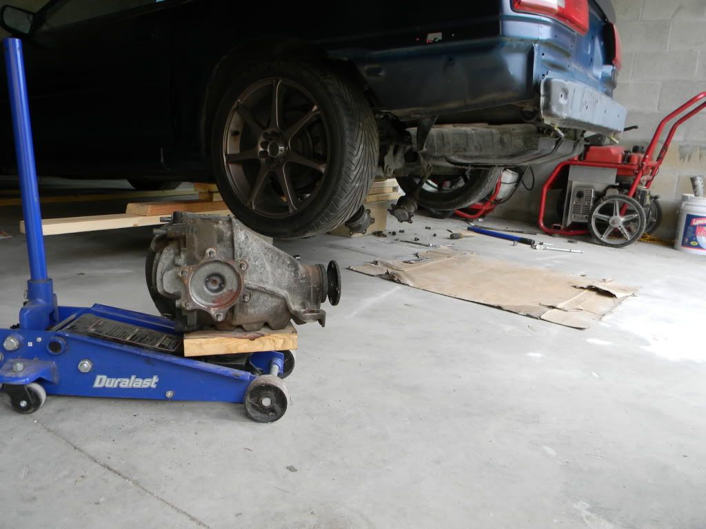

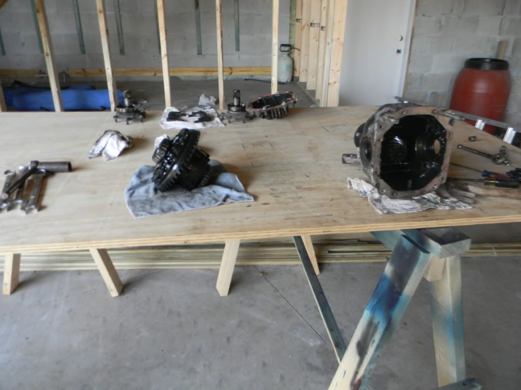

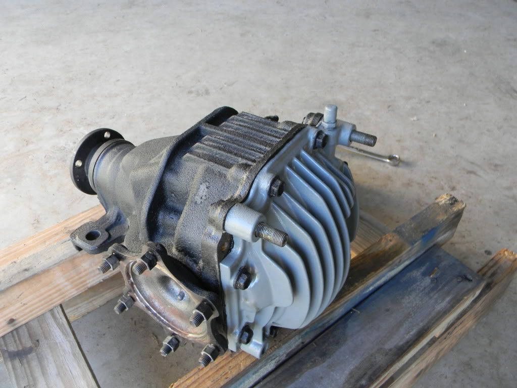

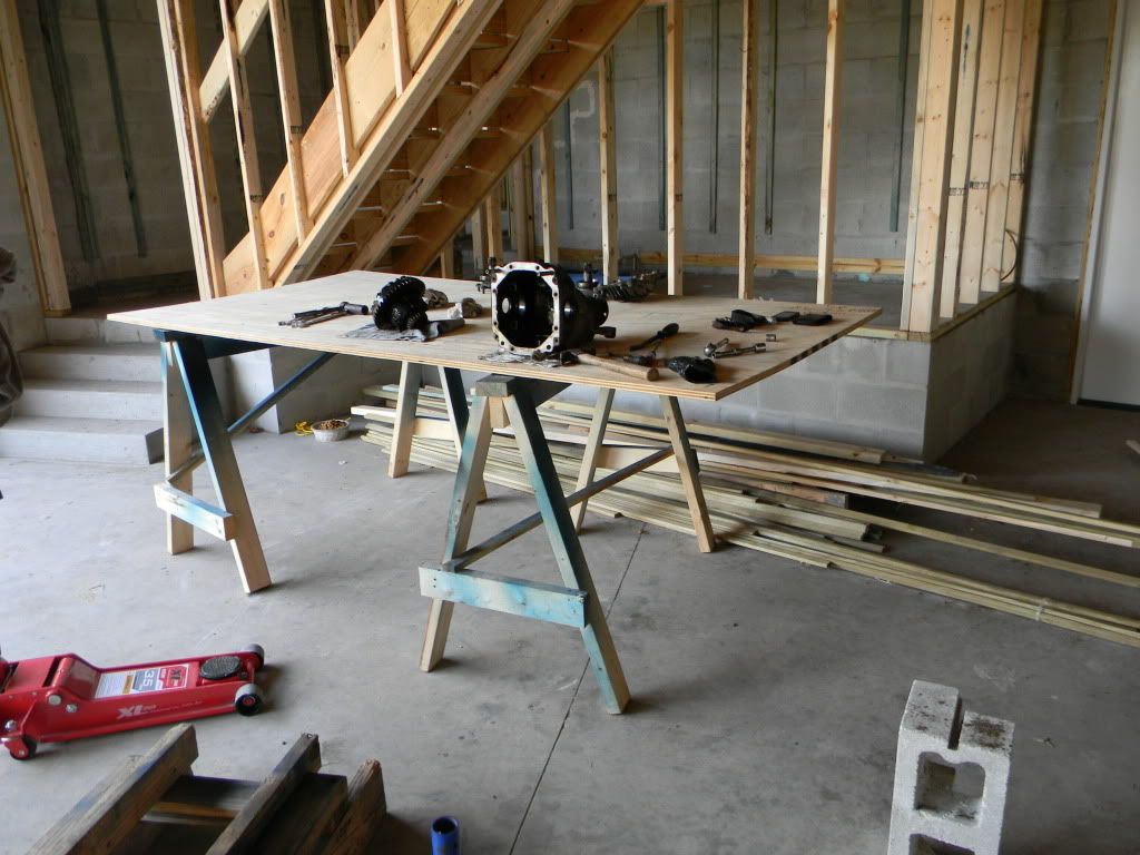

Rebuilding diff with weir performance stage 2 kit

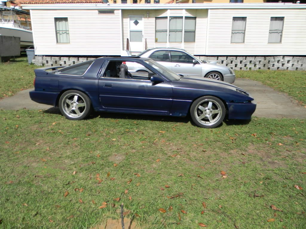

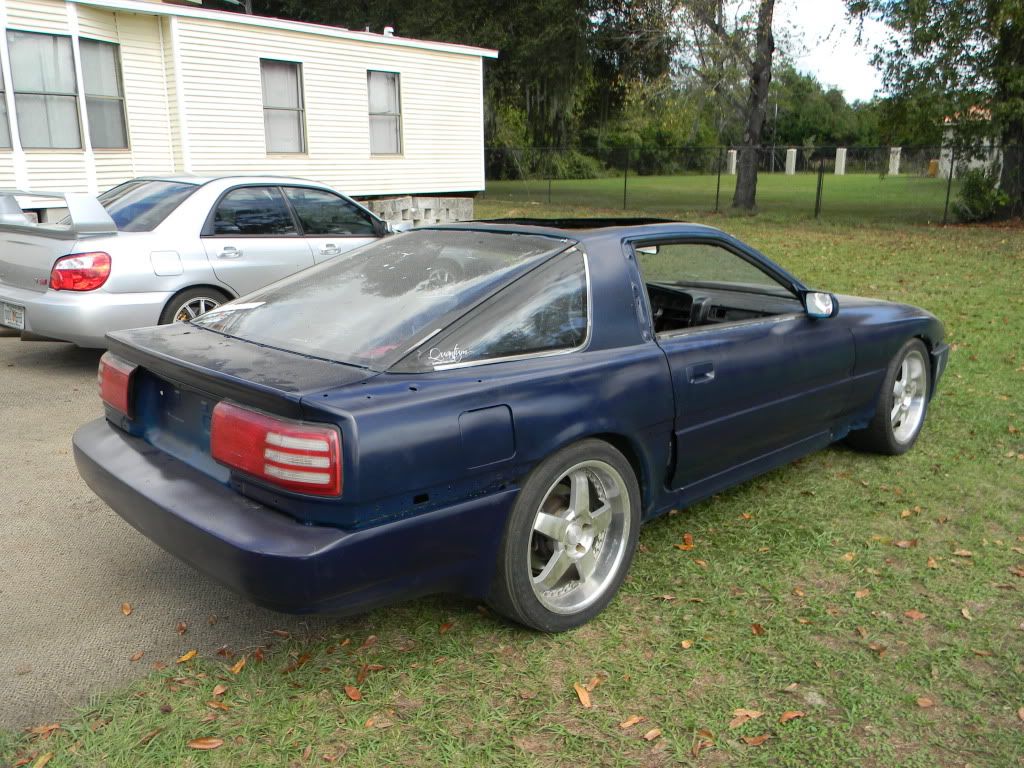

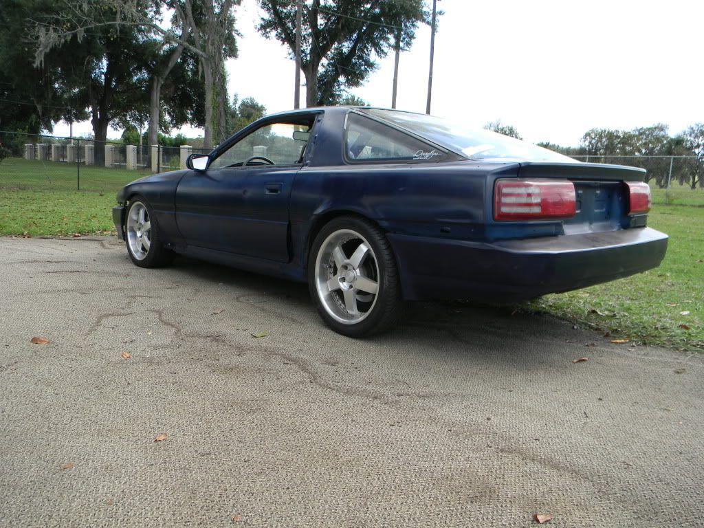

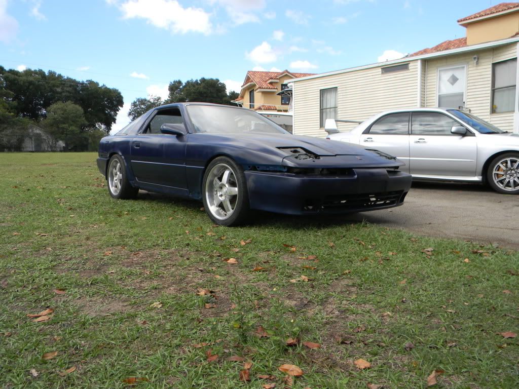

cant tell if i like it more wingless or with wing. i like'em both but i cant decide lol
and im pretty sure the diff is working much better with this weir performance stage 2 kit!!

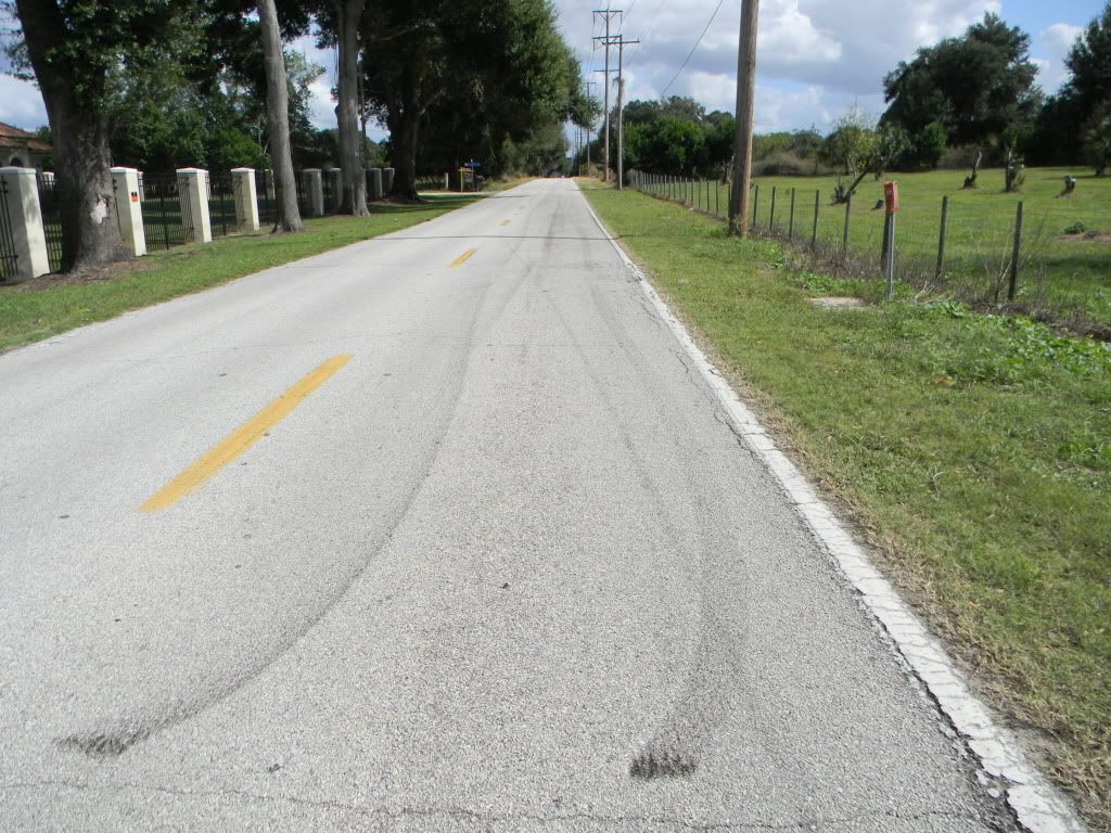

this\/ is a standing burnout then let off brake rev limiter in first, shift to second till rev limiter. proof that this is plenty of power. although more is always better!!

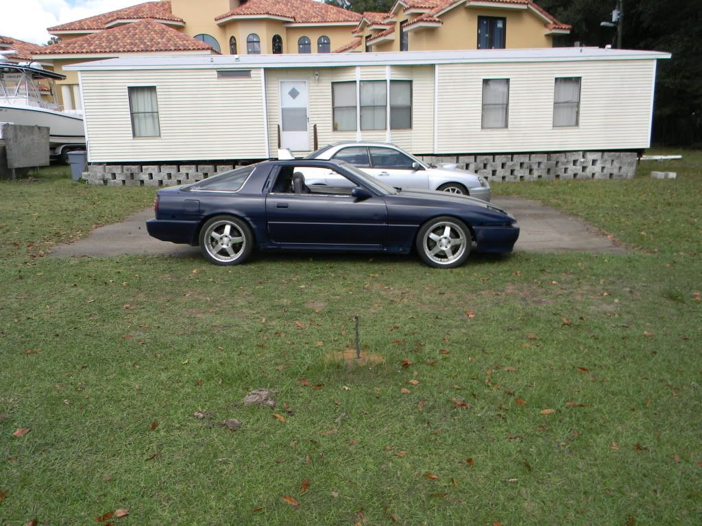

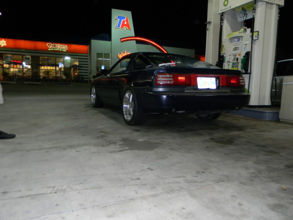

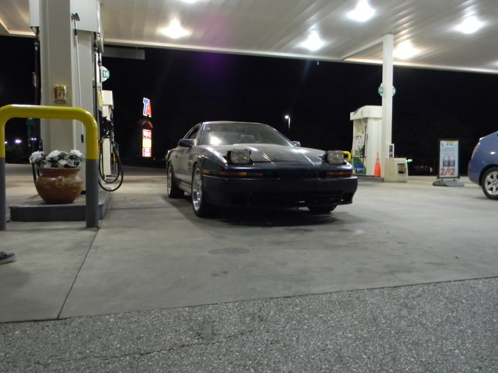

pics at the gas station!!!! lol car is so dirty tho. and it was 2am so i wasnt gonna wash it lol

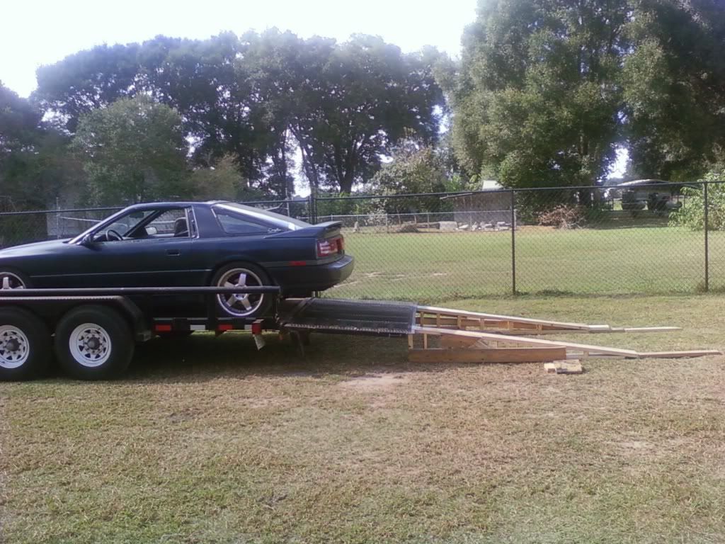

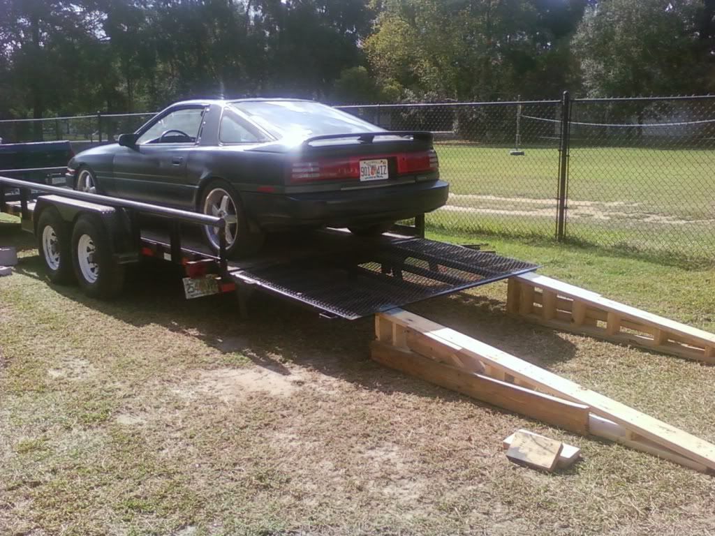

and i fixed my getting on to the equipment trailer problem :)

What fluid and how much lsd additive are you using in your diff? I have the same kit and it's effectively a welded diff. It never unlocks :/ I put in Ford Motorcraft 75W-90 and nearly all of the little bottle of LSD friction modifier and am prepared to put more in, but don't want it to get too loose.
P.S. the soundtrack in your video is pretty funny :biglaugh:
BrownMK3Kid
Dec 12, 2010
67
Tampa Florida
im just using regular old dino oil 75w-90 and it works like a charm.
