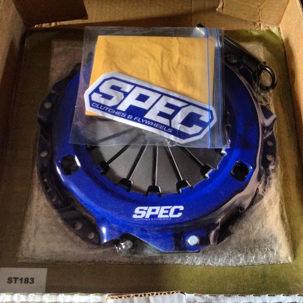

Got my spec stage 3 in from my buddies at brewedmotorsports.com and tossed this guy on her.
Got the motor all the way in the night after I got the clutch in and was up till 4am getting mostly everything done.

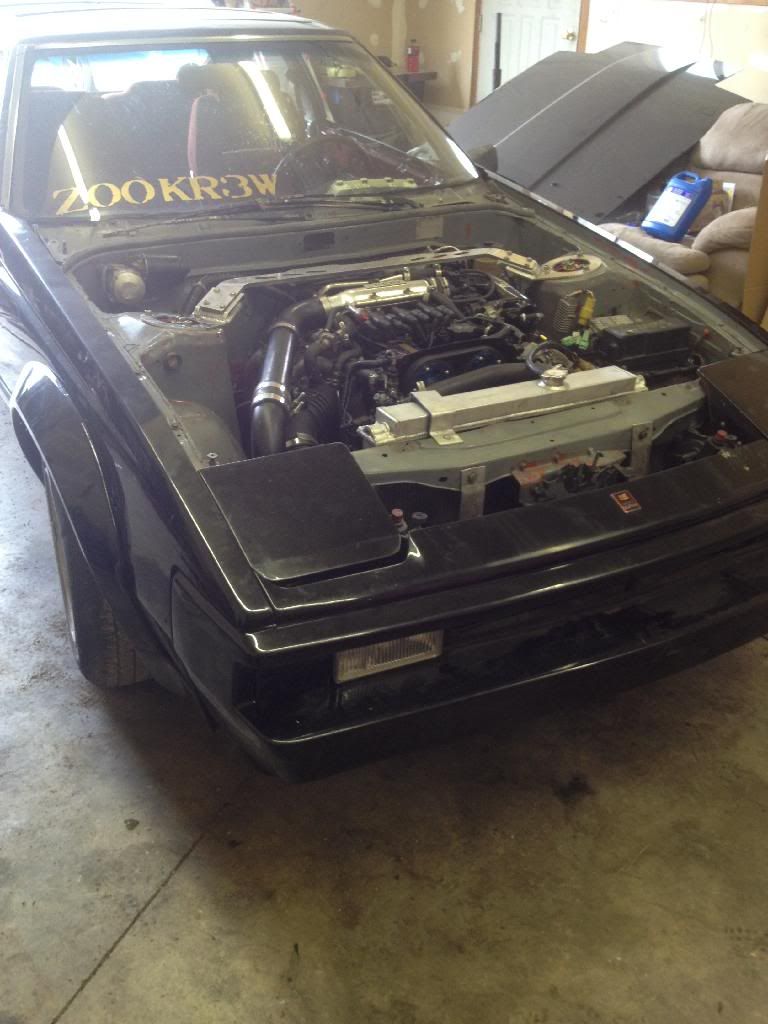

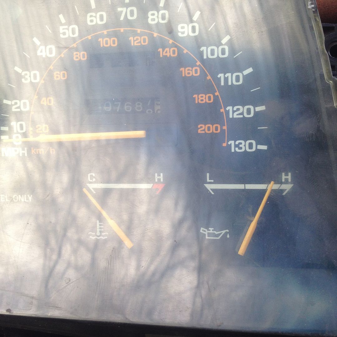

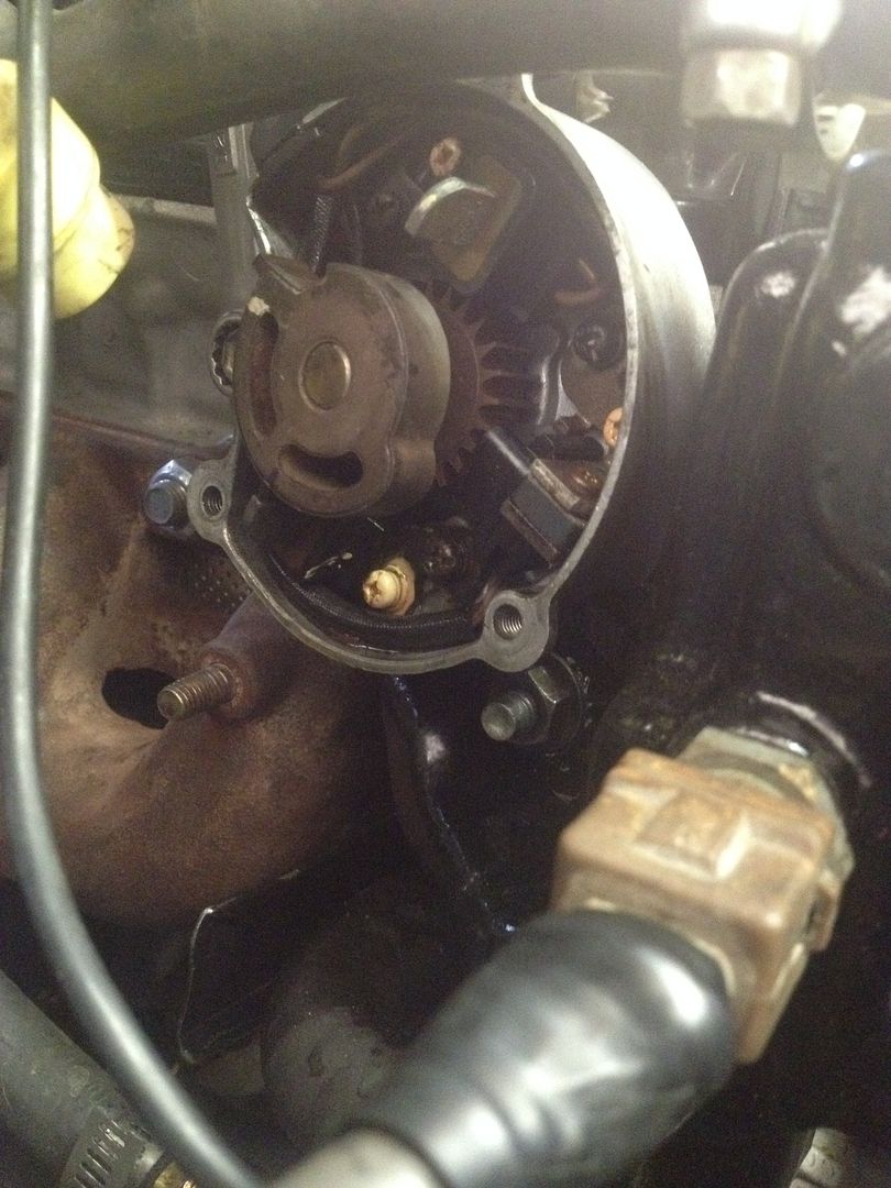

From a local friend I got a new IACV, coolant temp plug, and cps. Really helped with a handful of my running issues and does very well now! I have about 235 miles on the rebuild and she runs pretty darn strong. Really makes me realize how badly my old motor ran. Couple photos now!
So the drift motion upgraded oil pump does pretty well :) oil pressure gets way up there and once I toss on my oil cooler kit it should do awesome all the time. Once it gets fully warmed up it drops a little but thats going to happen.
Here you can kinda see the puddle of oil that was at the bottom of my old cas. The wires were also brittle and the wire wrap was pulled off in the plug and was corroded. Didnt even want to mess with it so just got a new one.
