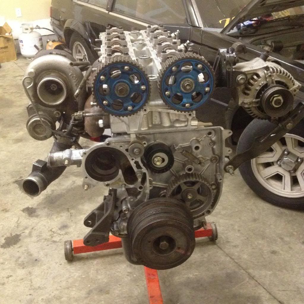

Back to me though, got some .5mm over pistons for the 7m.
Got the deck all shaved for a mhg and lubed up all the cyl walls.
Also painted it all and put in all new freeze plugs.
Little suspension shot after I installed new struts not to long ago, old ones got a little messed up.
Got all ALC Race bearings.
I also had arp rod bolts pressed in and all the connecting rods re rounded :)
Dropped in all my pistons.
Got a one off front sump drift motion modifyed oil pump. They used a cressida pump, moly coated the gears and put a stronger spring in the oil pump relief.
Also bought an an8 oil pump to block hose from driftmotion.
Buddy at brewed motorsports got me a cometic hg and new arp head nuts for a screaming deal!
Got the head all torqued down to spec with arp lube.
Also started doing all the shim gaps for the cams.

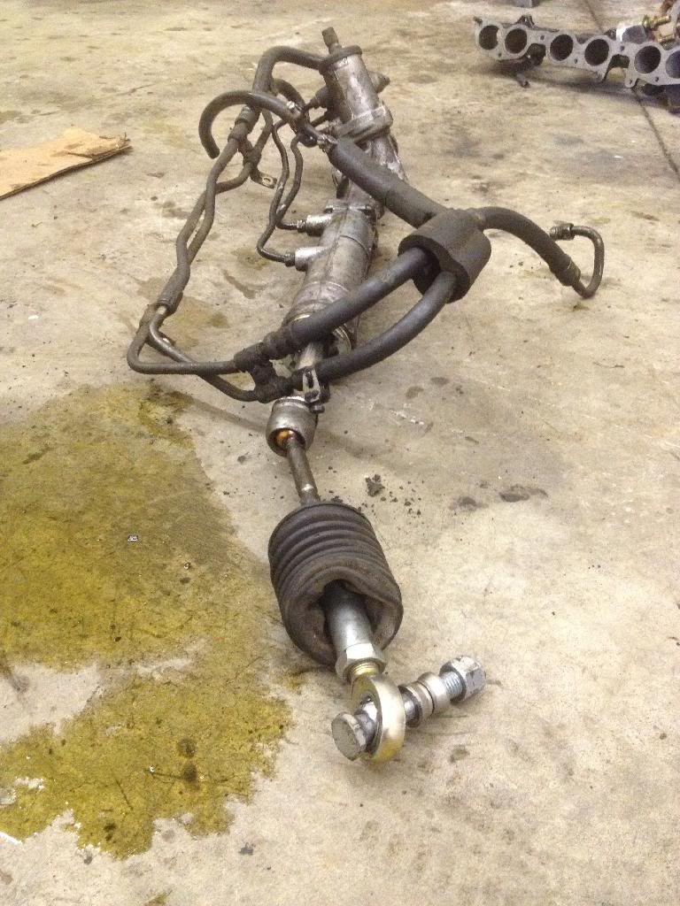

Had a long ass day yesterday and didn't have the desire to upload photos yet haha. So heres a few snaps.
yeppers pretty dang close! hopefully go in this next weekend!
Got all my power steering stuff figured out so I can finally have power steering again. You can see my beefy ass outer tie rods and the drop spacers to keep my tierods in check with the ground.
